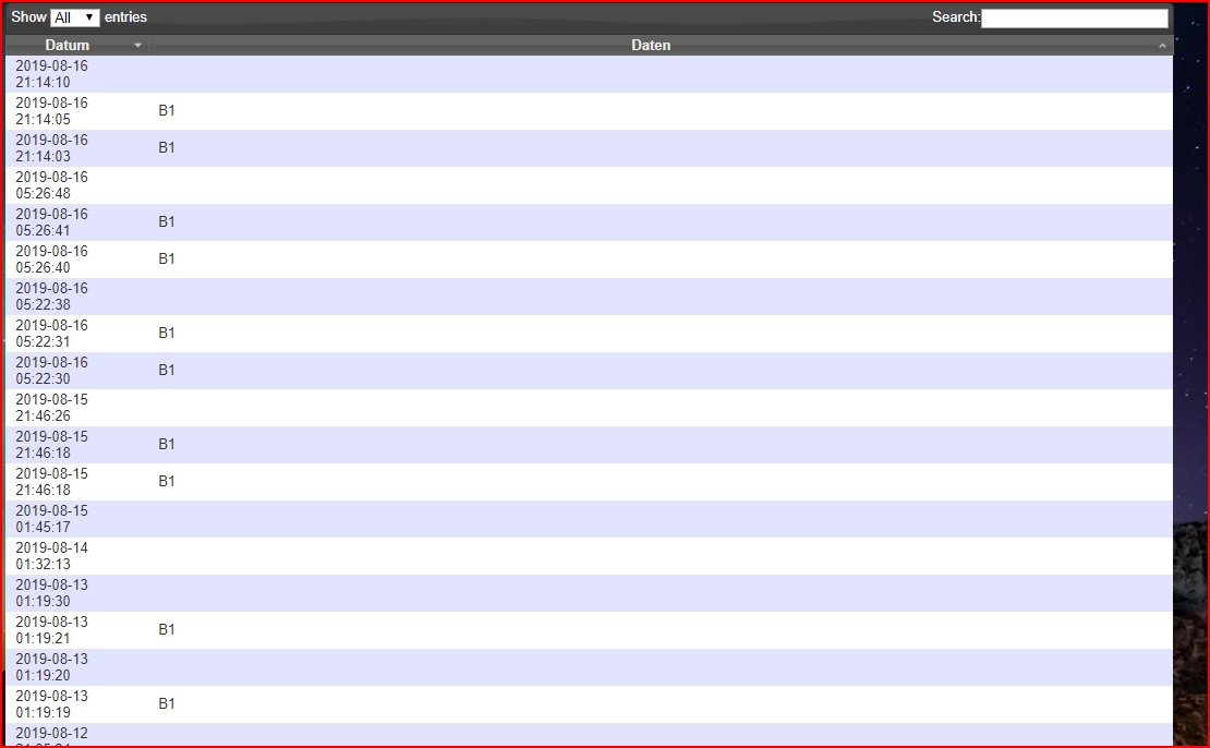

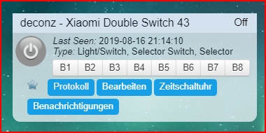

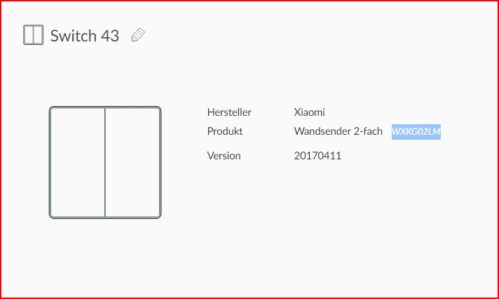

Hi, I have the switch WXKG02LM always a mistake when I press the.
But he works.
It seems that the only command of pressing comes but not let go of it?

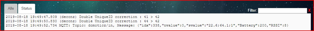

salopette
Posts: 187
Joined: Tuesday 07 March 2017 21:03
Location: Germany
Re: Python Zigbee plugin, deCONZ bridge (Using Conbee or Raspbee)
Post by salopette »
Thank you, now come no mistakes!
2019-08-18 19:14:05.153 (deconz) Double UniqueID correction : 41 > 42
2019-08-18 19:14:10.322 (deconz) Double UniqueID correction : 44 > 42
2019-08-18 19:14:23.399 (deconz) Double UniqueID correction : 44 > 42

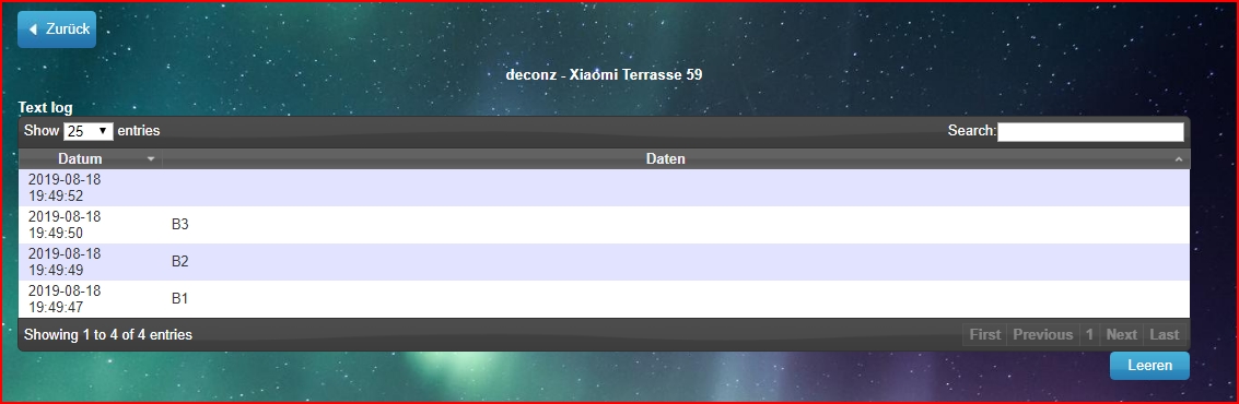

And both buttons are working ? You can have at least B1 B2 and B3 (or more according to the model)
salopette
Posts: 187
Location: Germany
Post by salopette »
Yes, the messages B1, B2, B3 are coming!
