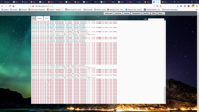

berrevoets
Joined: Monday 12 November 2018 12:40
Domoticz version: 4.10240
Location: kapelle,netherlands
Re: http/https poller
Post by berrevoets »
Hello lightmanster,
Great tht you spend time on this thing , i realy like to get it working.
but i run it to some problems withe the script
i get a message at line 6 (see pic)
6 json = (loadfile "/home/root/domoticz/scripts/lua/JSON.lua")() if i remove the last () then the next fault is move to line 10
10 local jsonData = json:decode(Stringjson) ( do not know how to troubleshoot further
Envoy2.txt
my lua script, without pw
(4.23 KiB) Downloaded 125 times
wat i did so far :
setup/harware ,create 1 dummy (idx10) and create 13 virtual sensors under it (idx 39-51) the custom type.
put lua script in events to let it run by domoticz (with serial numbers idx and pw)
also try to run it from home/pi/domoticz/scrips/lua
i hope you can help me out , i am new to working with these scripts , can not find out wat i am doing wrong.
Schermopname (76) small.png (169.97 KiB) Viewed 4146 times
Schermopname (77) small.png (322.71 KiB) Viewed 4146 times
berrevoets
just found one fault in my script, i wrote the serial numbers wrong in it without the first char.
still i get the same fault
2019-02-03 13:46:07.780 Error: EventSystem: in envoy 1paneel: [string "interval = 1..."]:6: attempt to call a nil value
i did login on the envoy, checked the serial numbers and the string my string lookslike:
"serialNumber": "121816023245",
"lastReportDate": 1549197357,
"lastReportWatts": 115,
"maxReportWatts": 164
next panel....
do i have to fill in a idx ? how wil it look like for one panel with the IDX =39 and the name is dummypanel1 ?
greetings marco

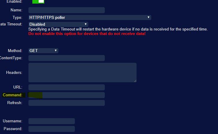

Minglarn
Posts: 214
Domoticz version: v3.8153
Location: Stockholm / Sweden
Post by Minglarn »
Is it possible to run a php script instead of a lua?
I really suck when it comes to lua. I do prefer PHP at all times. :)
At the command field I do want to run a PHP script running on my HTTP server...
Minglarn
Posts: 214
Post by Minglarn »
Well I guess not.
Feel kind of stupid to call a lua script and then php script from inside lua.
Well well. This should be changed in further versions of Domoticz.
