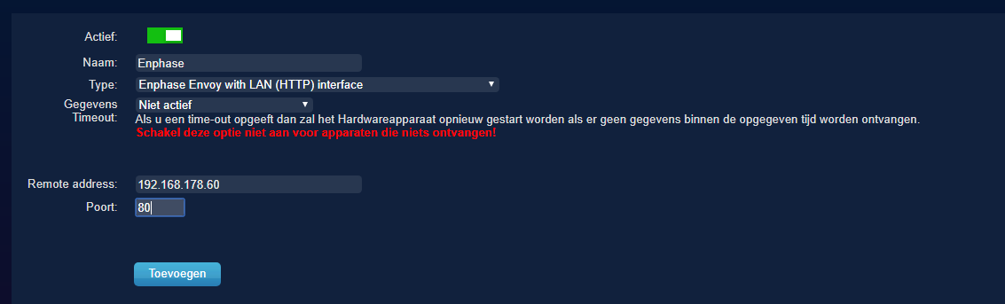

There is a possibillity to add a Enphase hardware item in Dotmoticz, but with wich portnumber do I have to add this device? Already tried 80 and 8080, won't work. Making a script is to difficult for me.

I get 2 extra devices (apparaten) when I add the Envoy in the Hardware' section with port 80.
These devices show thetotal kWh production and the current W's for all solarpanels together.
I'm not sure if these are the only devices I should get or if there should also be devices for individual panels. There is a JSON call that shows the current W's for individual panels. It would be great when more detailed information becomes available in domoticz also.
Is there information/documentation about this domoticz hardware?
Btw, maybe you have to enable 'accept new hardware' in the settings temporary. Otherwise the device aren't added automatically.

I'm able to update a virtual sensor with the http/https poller instructions of Machielw. But this is only the total production of all pannels.
The data per pannel is reachable through http://192.168.1.76/api/v1/production/inverters
However, you need to password of the installer account. Only if I login to http://192.168.1.76/installer/setup/home#overview, I can use http://192.168.1.76/api/v1/production/inverters, which than gives me:
    "serialNumber": "12180201xxxy",
    "lastReportDate": 1536516524,
    "devType": 1,
    "lastReportWatts": 0,
    "maxReportWatts": 257
    "serialNumber": "12180201xxxx",
    "lastReportDate": 1536516485,
    "devType": 1,
    "maxReportWatts": 264
(deleted all but 2 pannels)
If I use http://192.168.1.76/api/v1/production for the URL in HTTP/HTTPS poller and the installer login and password, I keep on getting
 Error: Http: Error getting data from url "http://192.168.1.76/api/v1/production/inverters"
I think this has to do with the accesibility and the login/password
