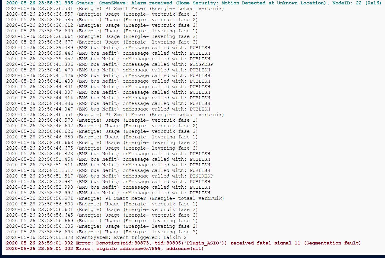

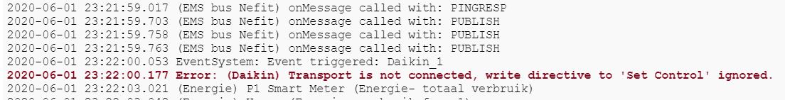

I need your help in understanding the following errors. The first attachment appears in the log when my Daikin event runs. Every evening around the same time the first error appears one or several times followed by the second error causes domoticz to stop.
Domoticz_Daikin fout4.JPG (50.72 KiB) Viewed 1593 times
