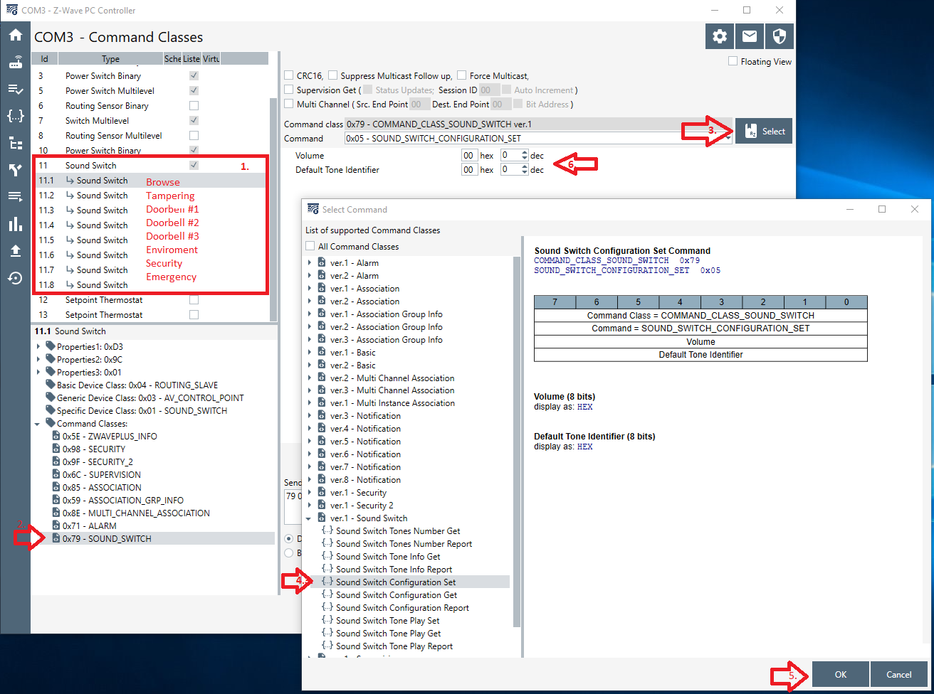

I just managed to configure the volume and the tone witch is trigged with the button.
Its a solution past domoticz. I used the windows software "Z-Wave PC Controller 5" to send the right commands to the doorbell. I just downloaded the software and plugged my Aeotec Z-Stick in. So I could communicate with each device in my Zwave network. With the help of the Aeotec Engineering Specifications (from the 2019-01-17) it's easily possible to detect the right command (classes) to configure each tone and volume for each trigger (Button 1-3, Tamperalarm, Zwave Alarm, etc).
Well, I just forgot to make some screenshots...

Hencor
Posts: 48
Joined: Sunday 01 September 2019 18:59
Domoticz version: 2021.1
Location: DE
Re: Aeotec Alarm 6 and Doorbell 6
Post by Hencor »
Hi raymond,
I just try to get all information / steps into a screenshot:
Doorbell Config Change.png (164.86 KiB) Viewed 8896 times
The send button is hidden by the Select Command window.
You can see that the SoundSwitch creates 8 different devices. Each device configure one trigger action.
The volume can be changed from 0 to 100 dec and the sound from 0 to 30 dec.
