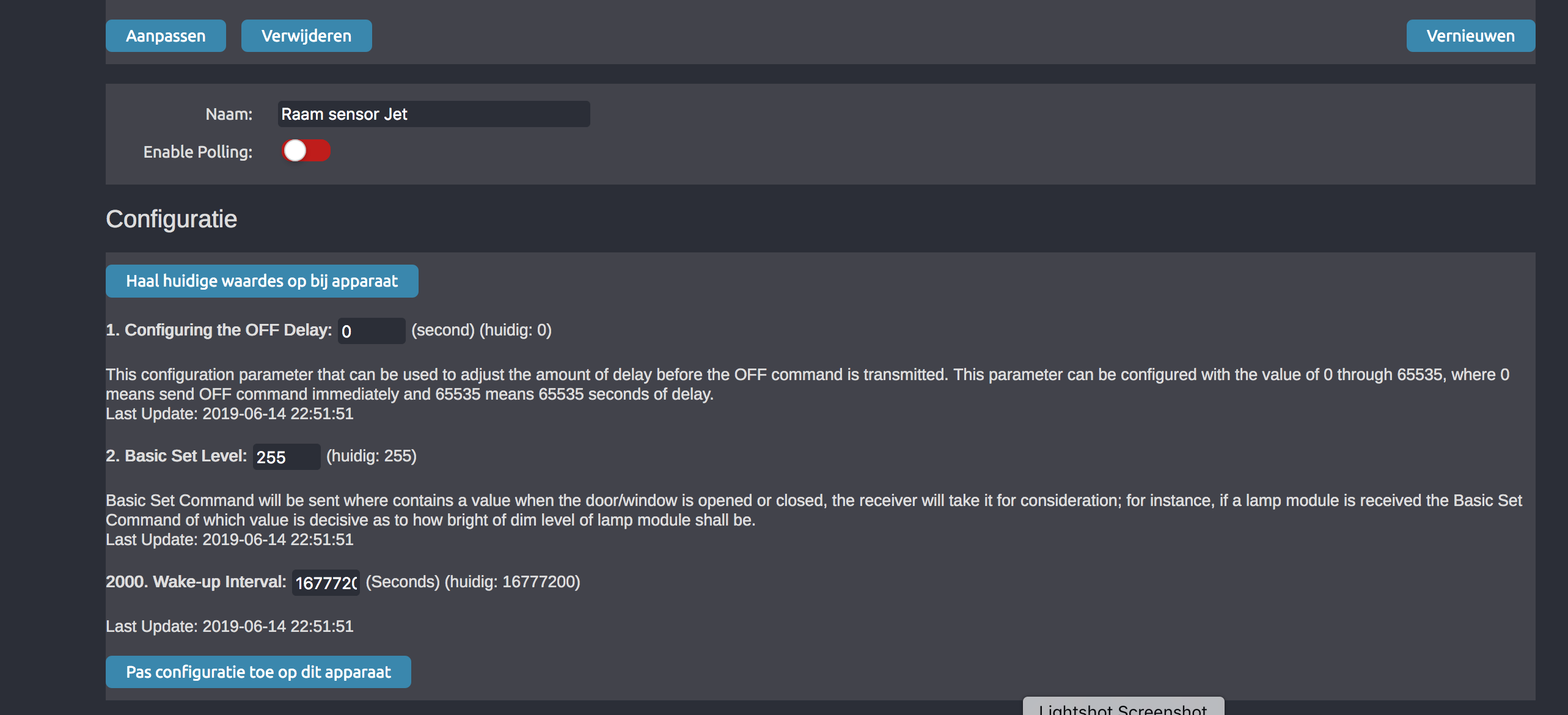

Something should be wrong, please check my settings (default) is this the same with you?
- Screenshot at Jun 16 14-08-54.png (261.92 KiB) Viewed 2216 times
