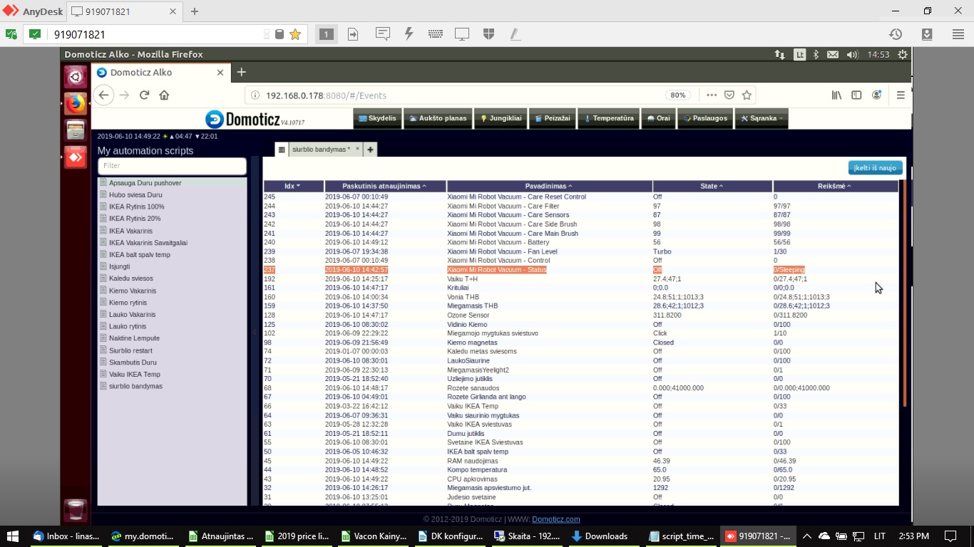

Dear Joep,
Yes, as button there is only 2 states of switch. On and Off,
But there is more information about state.
siurblio statusas.jpg (251.62 KiB) Viewed 9681 times
As You see in picture
Off 0/Paused
Off 0/Sleeping
Off 0/Charging
Off 0/In Error
On 1/Back to Home
On 1/Cleaning
These are states i saw until now. You even can find those values in "Status" button logs....
Hope someone could teach me how to use them in blocky script or at least dummy switch
EDIT:Looks like i can use that value with user variable.
Joep123
Posts: 56
Joined: Monday 26 March 2018 18:44
Re: Python plugin: Xiaomi Mi Robot Vacuum
Post by Joep123 »
KiiB wrote: Monday 10 June 2019 14:02 Off 0/Paused
Off 0/Sleeping
Off 0/Charging
Off 0/In Error
On 1/Back to Home
On 1/Cleaning
There is one more: "Off 0/Waiting".
