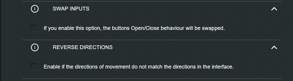

When a new Shelly 2.5 is added, it creates two blinds devices:
1. Venetian Blinds EU, which you do not have the chance to pick 'inverted'
2. Blinds Percentage, which you could change the switch type to Blinds Percentage Inverted if you need to do it.
Is there any chance to change the Venetian Blind EU to get the inverted behaviour (open/close) without changing wires?
salopette
- Posts: 187
- Joined: Tuesday 07 March 2017 21:03
- Domoticz version: BETA
- Location: Germany
Re: Python Plugin: Shelly MQTT
you can adjust it via the IP of the Shelly!
- sshot-2019-06-26-[1].jpg (108.74 KiB) Viewed 6424 times
But both buttons and Shelly app are ok, only it is inverted in domoticz
Could this option be?

josemi
- Posts: 31
- Joined: Thursday 08 March 2018 16:48
This option is what I was looking for. Thank you for implementing. I have activated it and both domoticz & shelly app are working in the same way.lwolf wrote: Friday 28 June 2019 21:21 Somebody says this way is good, other persons says the opposite. I am a little tired with this whole inversion thing, and i will not planning to rewrite this part again and again. This is why global inversion option created. Check or uncheck it as you wish.
