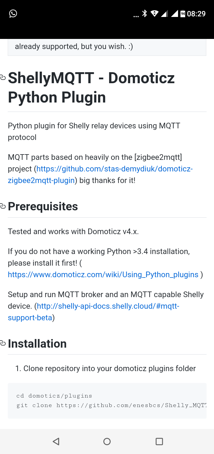

Posts: 84
Joined: Friday 12 August 2016 13:08
Re: Python Plugin: Shelly MQTT
Post by Gerwin »
That's strange ,
Look the picture
Here looks that it is possible with my preference
Gerwin

I have tested this plugin with Ubuntu 18.04 and Raspbian Stretch Linux, Python3.4.2 and Python 3.5.3 with Domoticz 4.9700 and 4.10427.
(However, for example Python 3.4.4 is published in 2015 and when i last checked my calendar it is 2019 now)
So it is up to you to debug the Verbose log file, that the Domoticz provides, than you will have some clue why your python environment does not work properly.
https://github.com/enesbcs/Shelly_MQTT/issues/5
