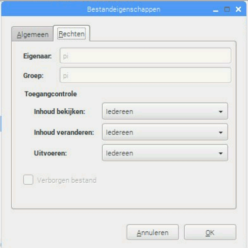

McJohn
- Posts: 91
- Joined: Wednesday 10 October 2018 17:01
- Domoticz version: 2020.2
Re: Run Terminal Commands on Request
Thanks for your tips & tricks.
I placed a sudo command in the first line into the script.
Nothing changed, it won’t work.
When I run the script (with the sudo command in it) remote from an ssh session, I got an error:
No protocol specified
Without the sudo command in the script it works perfectly with the SSH session; remote the Raspberry Screen wakes up!
The script has all rights for everyone, also for executing the script.
See screendump.
ps -ef | grep domoticz
gives:
root 657 1 8 mei30 ? 01:30:39 /home/pi/domoticz/domoticz -daemon -www 8080 -sslwww 443
pi 8984 8790 0 10:03 pts/1 00:00:00 grep domoticz
So, with a remote session, with user John, the script works perfectly:
pi@John:~$ /home/pi/domoticz/scripts/xscreensaverdeactivate.sh
Why won’t it work with Domoticz?
See screendump.
gives:
- Screen Shot 2019-05-31 at 10.12.26.png (166.14 KiB) Viewed 2410 times
- waaren
- Posts: 6028
So domoticz runs as root and root cannot succesfully executes the command.
So try something with runuser or the likes.
Google for the exact syntax.
I am not at home so limited access to Linux system.
Verstuurd vanaf mijn ONEPLUS A6003 met Tapatalk

McJohn
- Posts: 91
YESSS!!! It’s working!
I think with the remote ssh terminal session the rights won't accept an action locally from user "pi" (the owner of the script, see above screen dump).
BUT; with owner “pi” in the script it’s working perfectly directly from Domoticz at the Raspberry.
Now, with a specific Domoticz action we can wake up the Raspberry screen.
Thank you very much for the giant hint!
