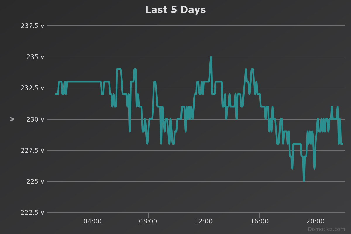

I already use one of my UPS as data-source, but closer to the source always better.
Attached a sample of my UPS and the voltage recorded.
- chart.png (100.9 KiB) Viewed 2146 times
