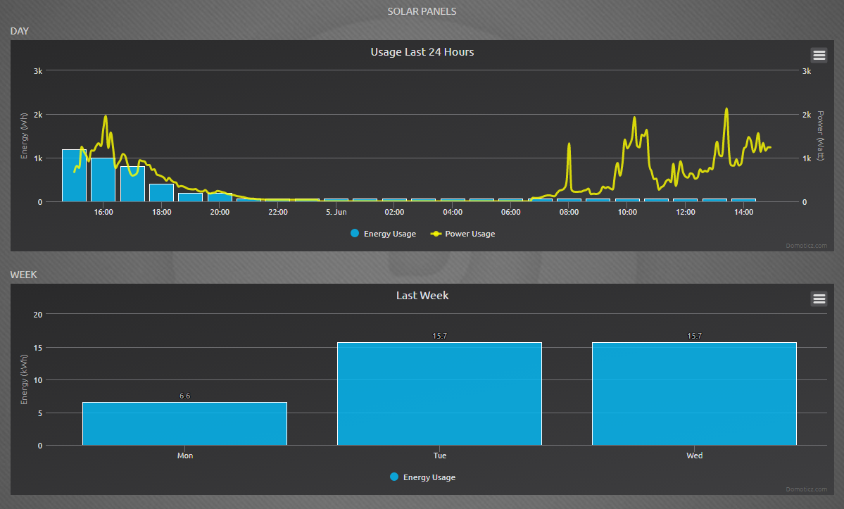

Re: GoodWe Solar: get data from the new semsportal (lua script)
I have implemented this script without to much problems. The only thing i see after a couple of days is that the total value of monday is al wrong. It's not 19.2 kWh, but more around 8.8 kWh if i check it in the semsportal.
All of the other days are correct, i dont get it. Does anybody have an idea?
- Capture.PNG (141.8 KiB) Viewed 4735 times
I experience the same issue as Marktap. The daily total of previous day is being used untill the currect day is higher for me.
I also notice when there is no power output I still get the last remain known output showing up (e.g 36Watts from 22:00h onwards till the morning).
Is there a way to set it to "0" when the solar system is offline?

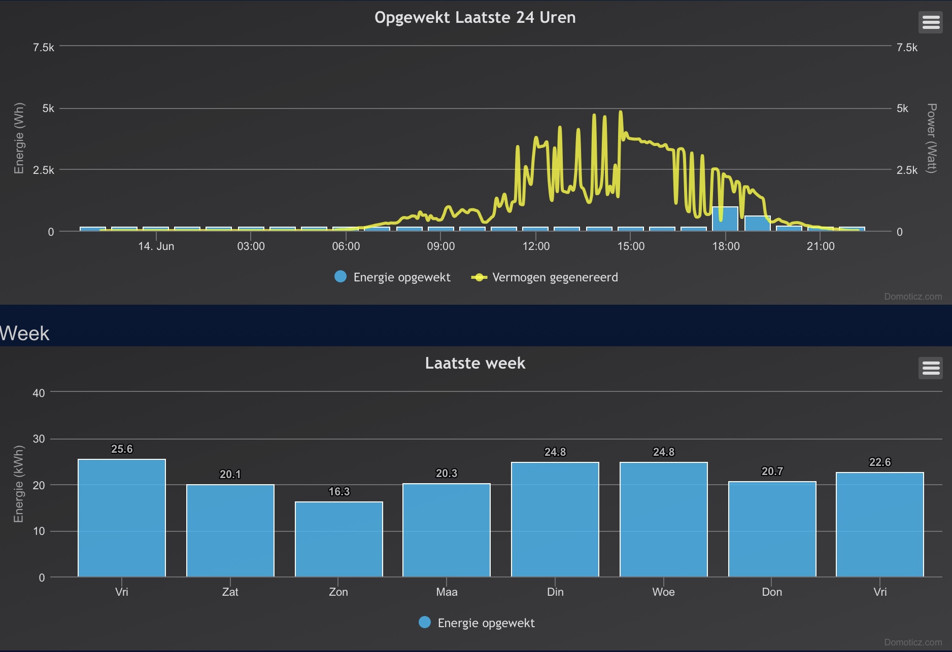

Also same problem.. Think of editing the database to correct..
Kencirot wrote: Wednesday 05 June 2019 14:56 I experience the same issue as Marktap. The daily total of previous day is being used untill the currect day is higher for me.
- 8A38ABA2-C638-4552-9236-8A2FC65B9F0B.jpeg (241.46 KiB) Viewed 4610 times

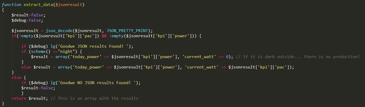

- sincze
- Posts: 1302
- Domoticz version: 2024.4
This seems to be an issue with all my different branded inverters indeed within domoticz.
Seems like a Domoticz representation graph issue to me as the json request is processed correctly and device is updated correctly as well. I am running Domoticz V4.10730.
That I corrected with a statement (not within lua) to check if the current time is after sunset. If so I update the device withpvdgulik wrote: Friday 14 June 2019 22:21 I also notice when there is no power output I still get the last remain known output showing up (e.g 36Watts from 22:00h onwards till the morning).
0;<daily_generation>.Pass2php

However you could also look at: https://github.com/sincze/Domoticz/blob ... Goodwe.php
