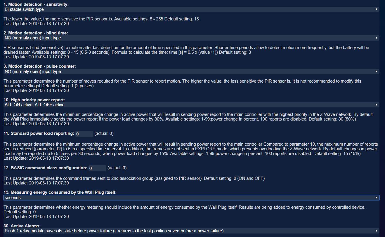

Gravityz
Posts: 652
Domoticz version: 2025.1
Re: domoticz in synology as package! Available now.
Post by Gravityz »
it seems after zwave v1.6 implementation the HW configuration info of most devices is totally wrong
it looks like it is using motion sensor settings for every device.
i did delete the zwcfg file and let it recreate without succes.
also copying the old zwave config files and let it recreate did not work.
i found out because HW scenes on my FGD212 did not work anymore
The only file which seems correct is the FGMS001-ZW5
ZMNHADx
FGWPF
FGD212
Gravityz

Gravityz wrote: Saturday 18 May 2019 20:11 @jumbotroll
i installed v785, much better but still there are some errors
are these related to the way you build the packages or is it related to a zwave module
There is no another way for me to crosscompile openzwave, so I think it is related to a zwave module..
If you like the work I do for synology and domoticz, I appreciate a donation.

Gravityz
Posts: 652
Post by Gravityz »
ok thanks Jumbotroll.
i already posted the problems on github
one is related to the earthquake sensor inside the fgms-001 which never worked in 1.4 and thus not on 1.6
The other one is related to scene functionality which is available and working in 1.4 but apparently not in 1.6.
can you create a new build with todays changes so i can do a test again?
questions regarding restoring:
i always go back to a previous working backup instead of restoring let's say a 785 build backup to a 734 version
is this true or does it not matter as long as the HW devices have not changed in the newer build (eg accept new hardware is always off)
