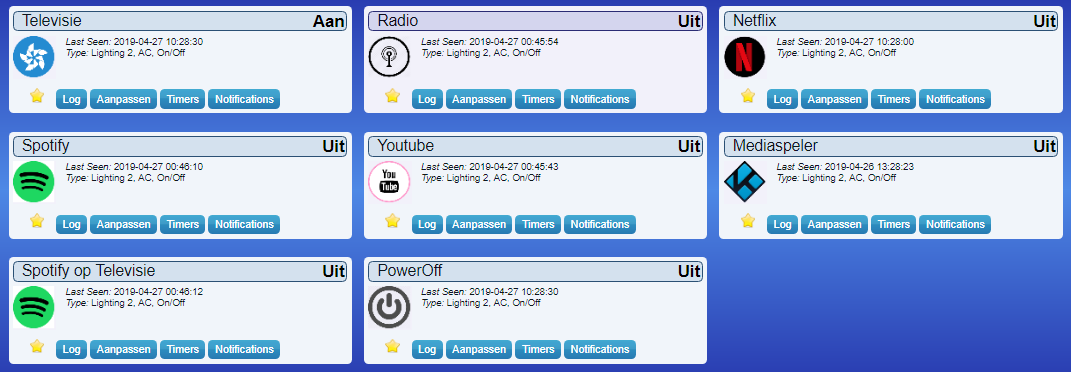

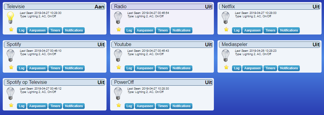

Hi, it looks like Google thinks all your devices are lights. Let me see what I can do today :)

Thanx Madgeni,
Problem solved!
Al the devices had a standard icon (lightbulb) and GH was trying to 'help' by identifying the devices as 'lights'.
after changing the icons the problem was fixed. I couldn't have fixed this without you. Many thanx!
