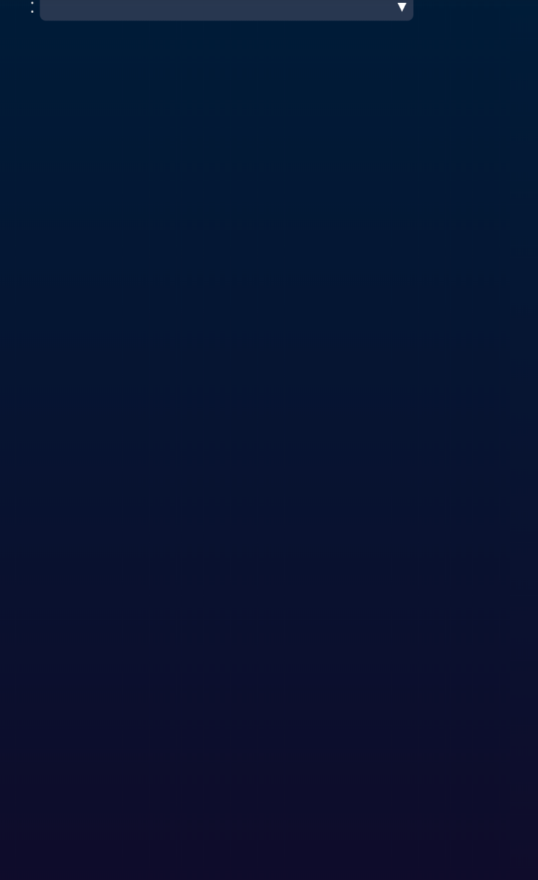

When I open the dashboard (192.168.0.200:8080) locally there are no problems. When I try to access it remotely the login(?) seems to hang at a screen like in the attachment. I have login set to BasicAuth.

Does the same problem occur with Firefox, Chrome and Edge?
I have had routers which have problems with portforwarding if port is 80 or 8080. There's some kind of conflict because those ports are used for accessing router settings. Connection was established but after few bytes connection halts. Browser showed empty page. To be sure try eg port 4040.

Chrome yes, tried Safari but it worked only once AND didnt prompt for password. Next time I connected it said Domoticz offline.
Again this is NOT a router problem because the system has worked fine but after updating Domoticz it does this.
Is there a fix for the Chrome problem which I read causes problems? On my Android Chrome is default and I would prefer to use it.

I had the same problems Butt after clearing cache of Chrome it is working Again, my idea about it was a Chrome update. You also putt a shortcut on your home screen? Remote it and replace it after clearing cache

OK, so most likely it's a browser problem: cache clearing works only once and even then not every time. Plus it is SLOW on android.
Easiest solution: I use incognito window on Chrome. Works every time and is fast as normal browsing.
Now I have to figure out how to make a shortcut on my phone desktop that opens an incognito window..
