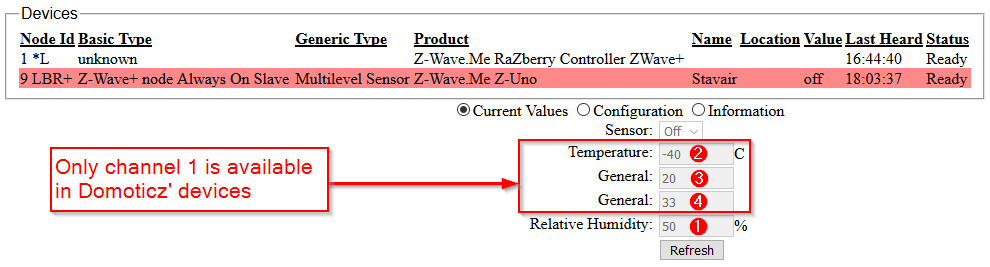

Hello, I have the same problem using a custom Z-Uno sensor with four channels :
  1. Relative humidity in %
  2. Air temperature in °C
  3. Air PM10 concentration (in µg/m3)
  4. Air PM25 concentration (in µg/m3)
In Domoticz only the first channel (Relative Humidity) is available, no matter how I configure the Z-Wave channels in the sensor (Z-Uno). However in the OpenZWave control pannel, my sensors are seen correctly :
Is there an XML file (or else) I could possibly update to make these missing channels available in Domoticz devices :?:
