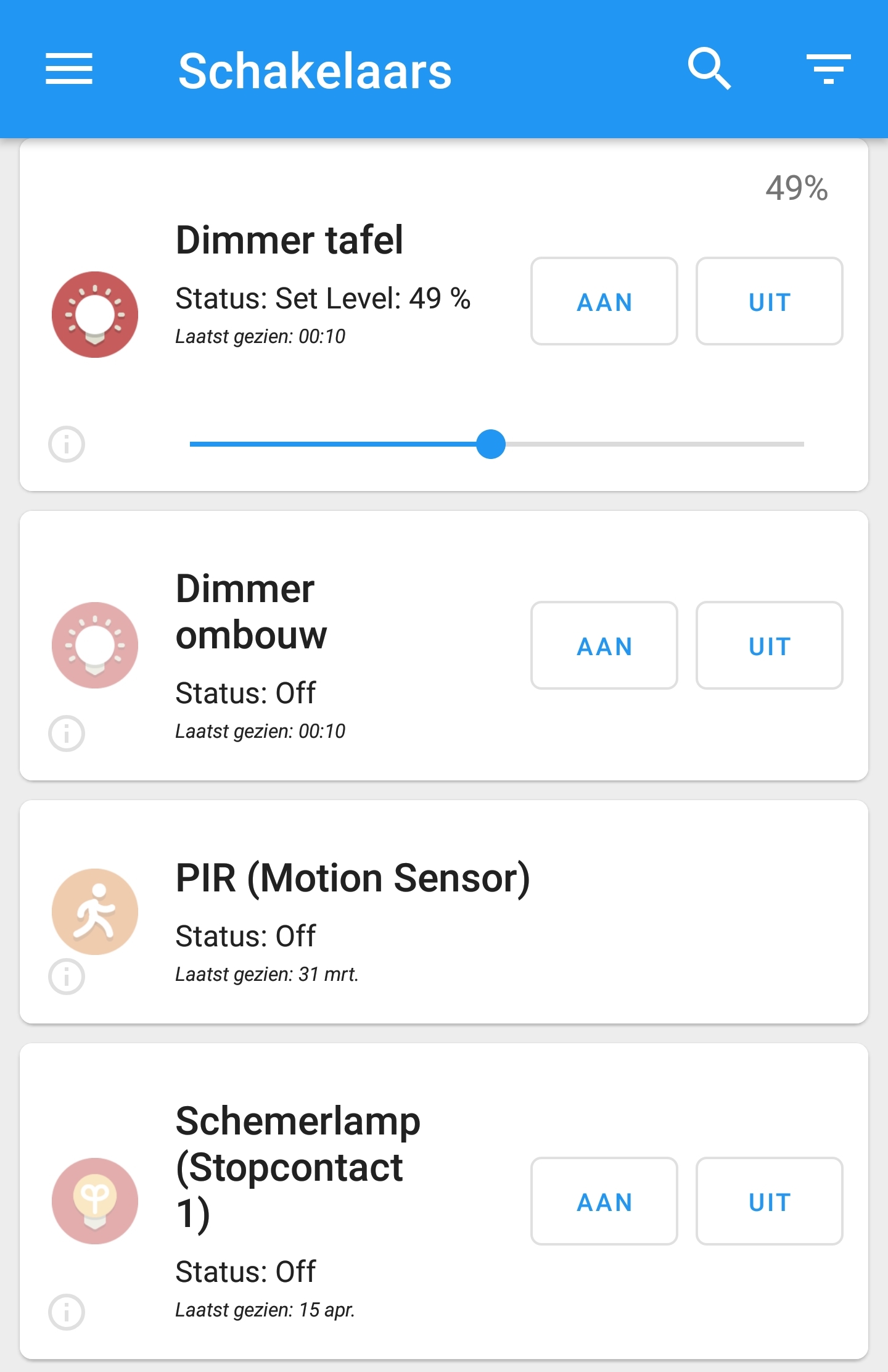

Dear all,
Is it possible to display dimmer switches/sliders even when the dimmer is turned off? With the "old" domotica application you can press at any point on the dimmer slider and the lamp will go on at that point.
With the new Domoticz app I first have to switch on the lamp with the toggle switch (lamp may go on at full brightness) and then adjust the slider. If it's dark in the house and the light go on at full force it's not that nice for your eyes.
If tests are needed I'm very willing to help.

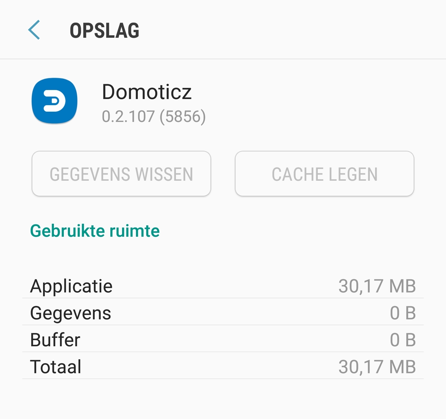

Right, I think I've finally discovered how to sort this.
What I had been doing (as I posted a while back) was to uninstall the app, and then delete the app folder - thinking (as did other users, apparently) that this would clear the cache and all app data from the phone. It clearly doesn't.
I've finally discovered what is meant by "clear the cache" in Android-speak. You mean go to the Android App settings, open the App info for Domoticz, touch Storage, and then use both the Clear Storage and the Clear Cache buttons...
That has finally reset the app, and now I see the hamburger menu. Got there eventually.
