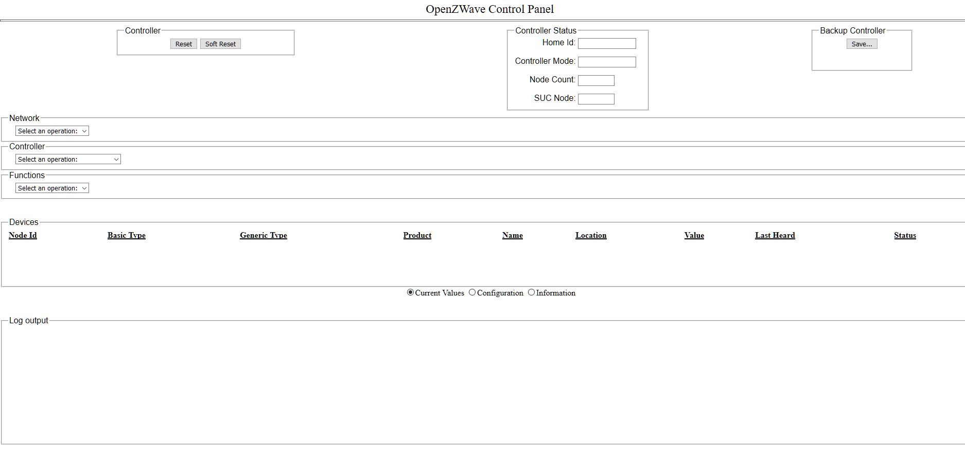

5. Additional to this problem I went to "Node management" followed by "Control Panel" and it's completely empty. No values what so ever are filled.
OpenZwave Control Panel.JPG (109.5 KiB) Viewed 605 times

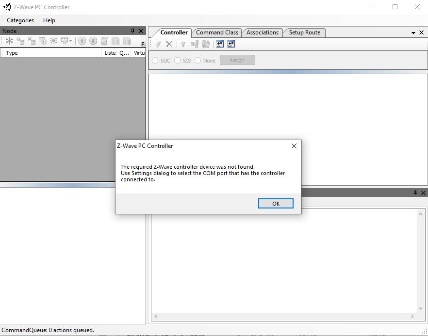

I reported this to the Aeontec helpdesk. They replied:
You can also help determine if it could be hardware related is to try software Zensys Tool and see if you can connect to it (easiest software for debugging and testing): http://www.axialcontrol.com/zensys-tools.zip. To connect Z-Stick with Zensys Tools go to (Categories -> Settings -> Select correct COM port -> Then press apply or OK).
Again it was'n possible to connect to Aeolab Zwave stick:
Attachment 4.JPG (57.83 KiB) Viewed 605 times
Strange that this tool doesn't find the Zwave stick at all, while Domoticz finds the stick and can use it to adjust switches etc.
As a result from problems 4 and 5 I'm not able to change any configuration of any device, not with Domoticz Setup Devices, not with the ZWave control panel in Domoticz and not with the seperate tool suggested by Aeontec Helpdesk.
