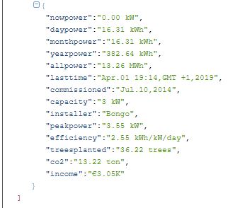

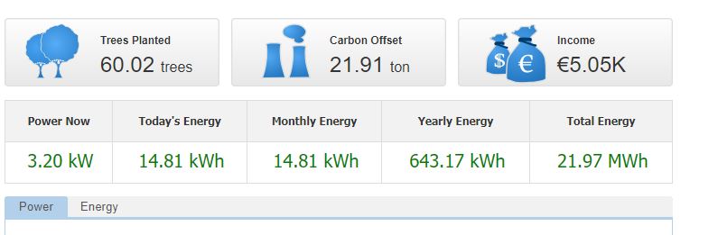

With a valid cookie you're able to retrieve everybodys info....
Just an example..
[{"nowpower":"3.20 kW","daypower":"14.81 kWh","monthpower":"14.81 kWh","yearpower":"643.17 kWh","allpower":"21.97 MWh","lasttime":"Apr.01 13:18,GMT +1,2019","commissioned":"Feb.05,2015","capacity":"450 kW","installer":"/","peakpower":"4.87 kW","efficiency":"0.03 kWh/kW/day","treesplanted":"60.02 trees","co2":"21.91 ton","income":"€5.05K"}]

At least it is possible to retrieve data from the portal without a login. :lol:

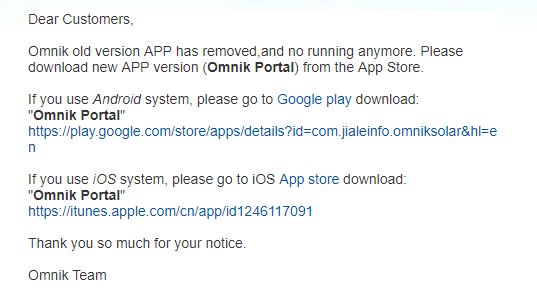

thijsvb wrote: Monday 01 April 2019 16:22 I'm experiencing issues with communication to the omnikportal:10000 as well!
Somebody received any information from their side yet?
It seems they dropped support for the old app. (old app used old api) and did not work anymore as well.
They now have a new app and that one is working.
However that is not the solution to my issue. Needs a bit more work. :lol:

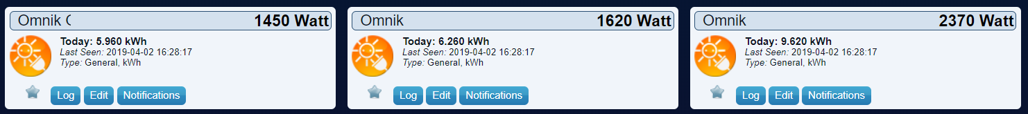

At least I can now monitor my friends again. :lol:

sincze wrote: Tuesday 02 April 2019 18:19
rednas wrote:
sincze wrote: Monday 01 April 2019 20:55 At least it is possible to retrieve data from the portal without a login. Image
How did you do this? :D
I did it in php (I am a pass2php user). I trick the omnik website to show me the data of my specific public sites and retrieve that data. Parse it and store it in Domoticz. :)Image
Sent from my ONEPLUS A6003 using Tapatalk
Is it possible to share this to us? :)
sincze
Posts: 1302
Domoticz version: 2024.4
Re: Ginlong, Omnik Solar, Solarman and Trannergy Inverters
Post by sincze »
rednas wrote: How did you do this? :D
Ofcourse that is what this community is about :) . Let me clean up the code a bit. As I am not a developer :) keep in mind it is in php. And based upon pass2php main scripts.
Pass2php
USB: RFXCom, ZWave, Sonoff 3
MQTT: ZIgbee2MQTT,
ZWAVE: Zwave-JS-UI
Solar: Omnik, PVOutput
Sensors: You name it I got 1.
sincze
Posts: 1302
Post by sincze »
This PHP is what I use at the moment to retrieve the info from the OMNIK public website.
#!/usr/bin/php
<?PHP
define('rootdir','/var/www/html/secure2/');
require(rootdir.'pass2php_include/settings.php');
if(isset($_REQUEST['text'])){ retrieve_omnik_data_api($_REQUEST['text']); }             // 02-04-2019 OMNIK API CHANGED!, The Command to parse is ; separated
function retrieve_omnik_data_api($command)			// 01-4-2019 NEW API IMPLEMENTED
    define('USERNAME', 'guest');			//The username or email address of the account.
    define('PASSWORD', '');					//The password of the account.
    define('USER_AGENT', 'Mozilla/5.0 (Windows NT 5.1) AppleWebKit/537.36 (KHTML, like Gecko) Chrome/35.0.2309.372 Safari/537.36');			//Set a user agent. This basically tells the server that we are using Chrome ;)
    define('COOKIE_FILE', 'cookie.txt');	//Where our cookie information will be stored (needed for authentication).
    define('LOGIN_FORM_URL', 'https://www.omnikportal.com/Terminal/TerminalDefault.aspx?come=Public');		//URL of the login form.
    define('LOGIN_ACTION_URL', 'https://www.omnikportal.com/Terminal/TerminalDefault.aspx?come=Public');	//Login action URL. Sometimes, this is the same URL as the login form.
    $continue=true;
    $postValues = array(
        'username' => USERNAME,
        'password' => PASSWORD
    $curl = curl_init();														//Initiate cURL.
    curl_setopt($curl, CURLOPT_URL, LOGIN_ACTION_URL);							//Set the URL that we want to send our POST request to. In this	case, it's the action URL of the login form.
    curl_setopt($curl, CURLOPT_POST, true);										//Tell cURL that we want to carry out a POST request.
    curl_setopt($curl, CURLOPT_POSTFIELDS, http_build_query($postValues));		//Set our post fields / date (from the array above).
    curl_setopt($curl, CURLOPT_SSL_VERIFYHOST, false);							//We don't want any HTTPS errors.
    curl_setopt($curl, CURLOPT_SSL_VERIFYPEER, false);							//We don't want any HTTPS errors.
    curl_setopt($curl, CURLOPT_COOKIEJAR, COOKIE_FILE);							//Where our cookie details are saved. This is typically required for authentication, as the session ID is usually saved in the cookie file.
    curl_setopt($curl, CURLOPT_USERAGENT, USER_AGENT);							//Sets the user agent. Some websites will attempt to block bot user agents. //Hence the reason I gave it a Chrome user agent.
    curl_setopt($curl, CURLOPT_RETURNTRANSFER, true);							//Tells cURL to return the output once the request has been executed.
    curl_setopt($curl, CURLOPT_REFERER, LOGIN_FORM_URL);						//Allows us to set the referer header. In this particular case, we are fooling the server into thinking that we were referred by the login form.
    curl_setopt($curl, CURLOPT_SSLVERSION, 4);
    curl_setopt($curl, CURLOPT_FOLLOWLOCATION, false);							//Do we want to follow any redirects?
    curl_exec($curl);															//Execute the login request.
	if(curl_errno($curl)){
		switch ($http_code = curl_getinfo($curl, CURLINFO_HTTP_CODE)) {
 			case 200:   $continue=true;# OK
 	    				//lg('Omnikinverter: Login: Expected HTTP code: ', $http_code);
        				break;
        	default:    $continue=false;
        				lg('Omnikinverter: Login: Unexpected HTTP code: ', $http_code);
  	if ($continue) {
	    $inverters = array(
	                        array( 'device' => "Omnik_1", 'id' => omnik_id_1 ),  // My PV id's that I monitor.
	                        array( 'device' => "Omnik_2", 'id' => omnik_id_2 ),
	                        array( 'device' => "Omnik_3", 'id' => omnik_id_3 )
	    foreach ($inverters as $inverter) {
	        $url='https://www.omnikportal.com/AjaxService.ashx?ac=upTerminalMain&psid='.$inverter['id'].'&random='.rand();
	        //lg('Omnikinverter: '.$inverter['device'].' '.$url);
	        curl_setopt($curl, CURLOPT_URL, $url);						//We should be logged in by now. Let's attempt to access a password protected page
	        curl_setopt($curl, CURLOPT_COOKIEJAR, COOKIE_FILE);			//Use the same cookie file.
	        curl_setopt($curl, CURLOPT_USERAGENT, USER_AGENT);			//Use the same user agent, just in case it is used by the server for session validation.
	        curl_setopt($curl, CURLOPT_SSL_VERIFYPEER, 1);				//We don't want any HTTPS / SSL errors.
	        curl_setopt($curl, CURLOPT_SSL_VERIFYHOST, 2);				//We don't want any HTTPS / SSL errors.
	        $result = curl_exec($curl);									// Execute the GET request and print out the result.
 	    						//lg('Omnikinverter: Data: Expected HTTP code: ', $http_code);
        						break;
        						lg('Omnikinverter: Data: Unexpected HTTP code: ', $http_code);
			if ($continue) {
		        $data = json_decode($result, JSON_PRETTY_PRINT);
		        $nowpower = $data[0]['nowpower'];
		        $todaypower = $data[0]['daypower'];
		        $nowpower = filter_var( $nowpower, FILTER_SANITIZE_NUMBER_FLOAT);
		        $todaypower = filter_var( $todaypower, FILTER_SANITIZE_NUMBER_FLOAT);
		        $str=( (round($nowpower)*10).';'.($todaypower*10) );
		        lg('Omnikinverter: '.$inverter['device'].' result: '.(round($nowpower)*10).' and: '.($todaypower*10).' for domoticz: '.$str);
		        if (isset($nowpower) && isset($todaypower) ) ud($inverter['device'],0,$str,'Omnikinverter: Generation updated');
	curl_close($curl);														// close cURL resource, and free up system resources
