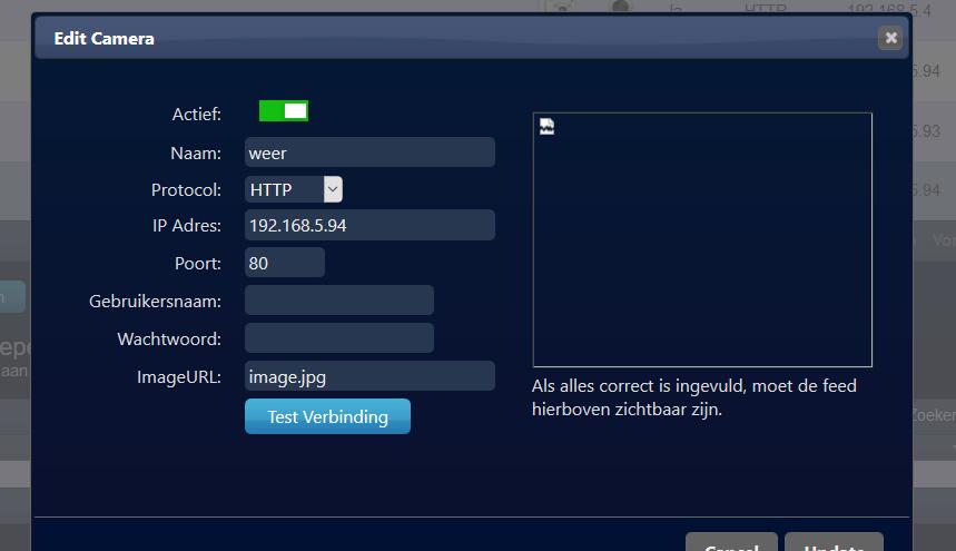

Hi!
First of all excuse my bad english.
I added my Xiaomi Dafang Camera with DafangHack firmware to my domoticz and it worked for a couple of months.
Now can´t see the camera in the domoticcz windows but the connection test apears to be fine and displays the camera.
Someone knows what can be happen?
Thanks in advance for your help.
Regards.

Resolved.
Edit and coment o remove these lines in /system/sdcard/config/lighttpd.conf
$HTTP["scheme"] == "http" {
# capture vhost name with regex conditiona -> %0 in redirect pattern
# must be the most inner block to the redirect rule
$HTTP["host"] =~ ".*" {
url.redirect = (".*" => "https://%0$0")
This disable the https redirection.
