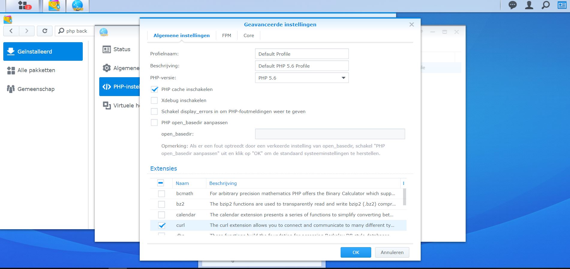

* In "Web station" -> "PHP settings" verify that the curl extension is selected.

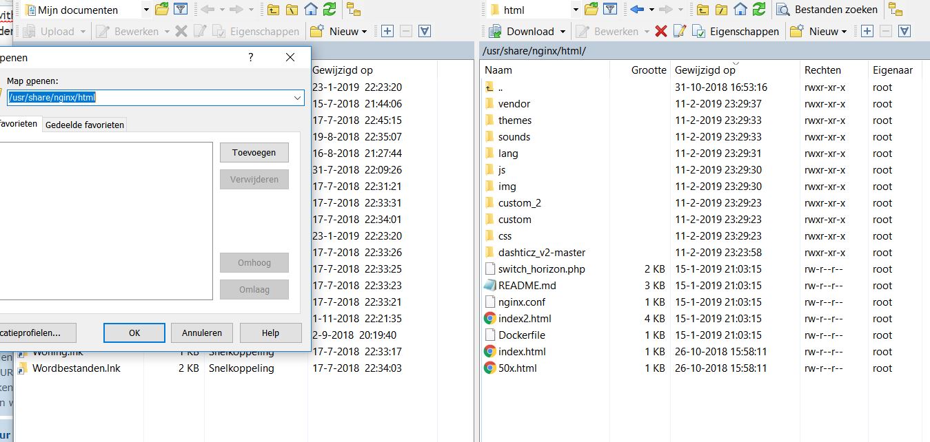

Thanks a lot Lokonli. So I understand now what the webstation mean. But I have now a problem. The steps you told, I've done. But now I get an fould 404. Do you know what is wrong? (see printscreens)
Ps. I download the file Dashticz from this URL: https://github.com/Dashticz/dashticz_v2 ... c30862827c

Got it to work, the target directory is wrong.
You need to install the dashticz_V2 folder in:
/volume1/web
approach with:
IP/dashticz_V2

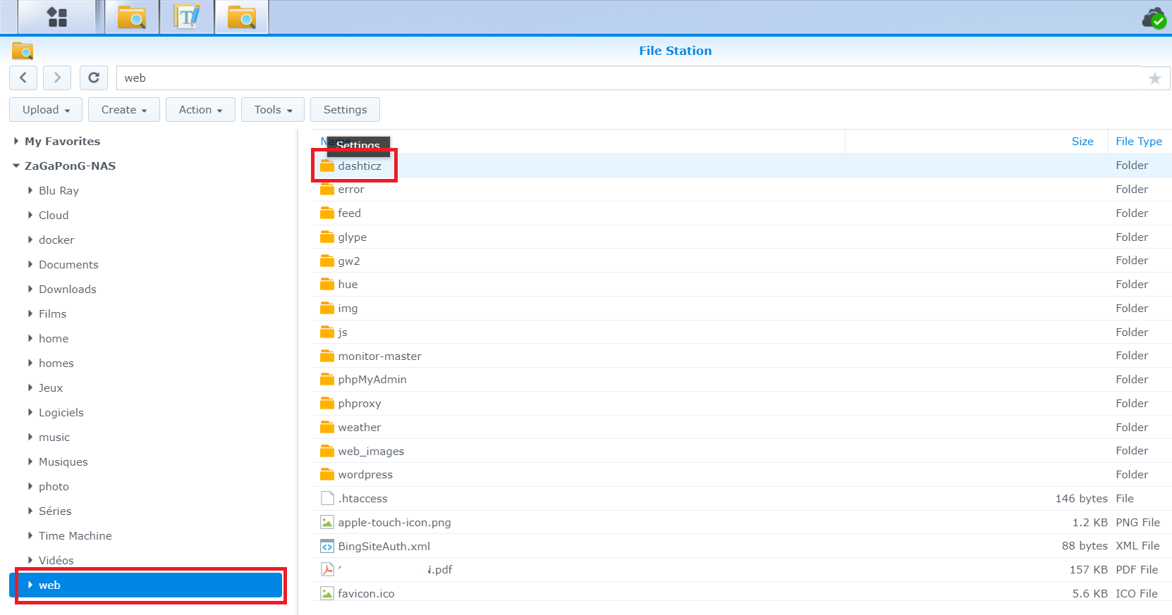

- Install the package "Web Station"
- Download the zip from "beta" branch and paste it into your "web" folder directly with "File Station"
- Unzip the zip with "File Station"
- Your Dashticz will be available at this address: your.ip/yourdashticzfolder (eg: 192.168.0.50/dashticz)
