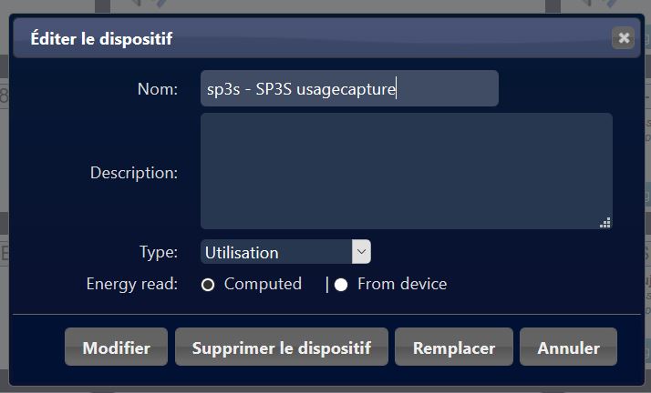

This is my first post here and I would like to get assistance with Broadlink SP3S configuration.
I've followed this guide (https://www.domoticz.com/wiki/Plugins/BroadlinkRM2.html) in order to install the plugin.
I would say everything works fine except of the one thing.
I can't figure out how to configure the meter in order to calculate energy usage per day/week/month...
Current energy consumption is being displayed correctly, the issue is only with total values.
IDX   Hardware  ID                Unit   Name                           Type         Subtype    Data
25  BR           000A0002      2        BR - SP3S CURRENT               Usage        Electric   909.36 Watt
26  BR           000A0003      3        BR - SP3 USAGE                  General      kWh        0, 909.36
When I go to the utility tab I see only values, taken from the IDX 25(current consumption).
Configuration of the device IDX 26 is:
Energy read: From device
Type - Usage.
In this case it doesn't show anything, so the graphs are just empty.
If I put Type - Usage, Energy read - Computed, the plugin crashes.
2019-03-26 14:56:47.723 (BR) Update 0:'912.16' (BR - SP3 USAGE)
2019-03-26 14:56:47.760 (BR) Power state : True
2019-03-26 14:56:47.797 (BR) Light state : False
2019-03-26 14:57:17.603 (BR) Pushing 'onHeartbeatCallback' on to queue
2019-03-26 14:57:17.616 (BR) Processing 'onHeartbeatCallback' message
2019-03-26 14:57:17.616 (BR) Calling message handler 'onHeartbeat'.
2019-03-26 14:57:17.617 (BR) SP3S called
2019-03-26 14:57:17.738 (BR) Energy : 907.68
2019-03-26 14:57:17.739 (BR - SP3S CURRENT) Updating device from 0:'912.16' to have values 0:'907.68'.
2019-03-26 14:57:17.742 (BR) Update 0:'907.68' (BR - SP3S CURRENT)
2019-03-26 14:57:17.743 (BR - SP3 USAGE) Updating device from 0:'912.16' to have values 0:'907.68'.
2019-03-26 14:57:17.746 (BR) Update 0:'907.68' (BR - SP3 USAGE)
2019-03-26 14:57:17.783 (BR) Power state : True
2019-03-26 14:57:17.820 (BR) Light state : False
2019-03-26 14:57:19.742 (BR) Pushing 'CPluginMessageBase' on to queue
2019-03-26 14:57:19.742 Status: EventSystem: reset all device statuses...
2019-03-26 14:57:19.776 (BR) Processing 'CPluginMessageBase' message
2019-03-26 14:57:19.777 (BR) Message handler 'onDeviceModified' not callable, ignored.
2019-03-26 14:57:47.609 (BR) Pushing 'onHeartbeatCallback' on to queue
2019-03-26 14:57:47.643 (BR) Processing 'onHeartbeatCallback' message
2019-03-26 14:57:47.643 (BR) Calling message handler 'onHeartbeat'.
2019-03-26 14:57:47.643 (BR) SP3S called
2019-03-26 14:57:47.785 (BR) Energy : 905.84
2019-03-26 14:57:47.785 (BR - SP3S CURRENT) Updating device from 0:'907.68' to have values 0:'905.84'.
2019-03-26 14:57:47.789 (BR) Update 0:'905.84' (BR - SP3S CURRENT)
2019-03-26 14:57:47.789 (BR - SP3 USAGE) Updating device from 0:'907.68' to have values 0:'905.84'.
2019-03-26 14:57:47.790 Error: Domoticz(pid:21854, tid:21873('PluginMgr')) received fatal signal 11 (Segmentation fault)
2019-03-26 14:57:47.790 Error: siginfo address=0x52422820, address=0x76ca057c
2019-03-26 14:57:57.267 Error: Thread 4 (Thread 0x74fbe430 (LWP 21873)):
2019-03-26 14:57:57.267 Error: #0 0x76ef24cc in __waitpid (pid=22028, stat_loc=0x74fbc868, options=0) at ../sysdeps/unix/sysv/linux/waitpid.c:29
2019-03-26 14:57:57.267 Error: #1 0x002c9af0 in dumpstack_gdb(bool) ()
2019-03-26 14:57:57.267 Error: #2 0x002ca0dc in signal_handler(int, siginfo_t*, void*) ()
2019-03-26 14:57:57.267 Error: #3 <signal handler called>
2019-03-26 14:57:57.267 Error: #4 __GI_____strtof_l_internal (nptr=0x52422820 <error: Cannot access memory at address 0x52422820>, endptr=0x0, group=<optimized out>, loc=0x76fd7b18) at strtod_l.c:583

After certain manipulations with server restart/disabling the hardware and devices I could force this meter to calculate computed daily consumption without crashes.
My questions are the following:
1) What is the correct way to configure this meter, should the value be "computed" or "from device"?
2) If it's computed, what the reason of plugin crash is that a known issue ?
3) If the value should be "From device" how I could force domoticz to show it in the utility meter?
Thanks for any help.
