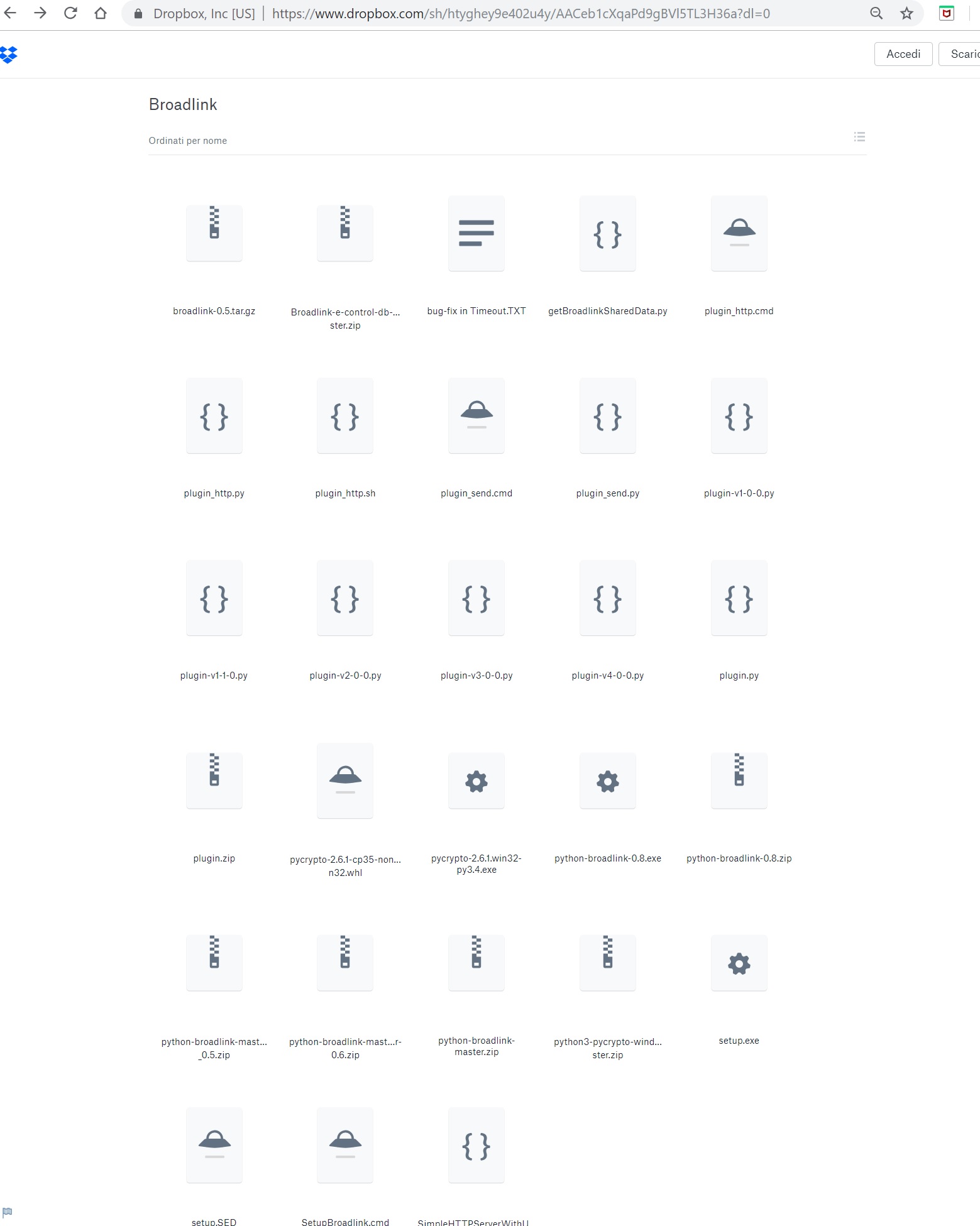

I'm sorry,
but I can not find the 4.2 plugin
where is it?
where is it?
- pluginbroad.jpg (191.33 KiB) Viewed 2369 times
zak45
- Posts: 954
- Joined: Sunday 22 January 2017 11:37
- Target OS: Windows
- Domoticz version: V2024.4
Re: Python Plugin : Broadlink RM2 V4
plugin.py is always the last one.
