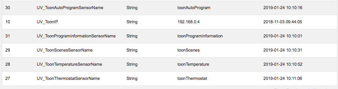

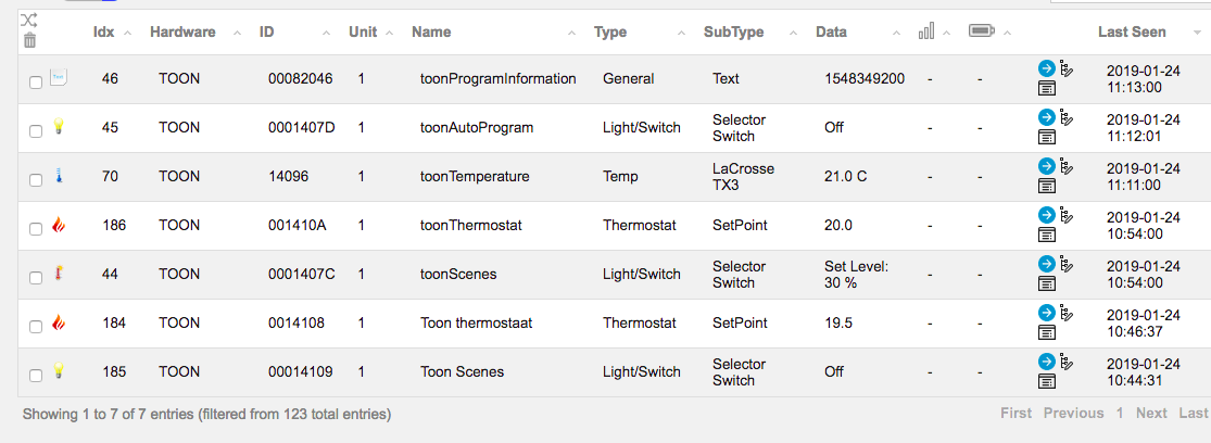

Thanks for this. I used to use another version for hacked Toon's, but somehow that doesn't want to work for me. Going to give this a change.
EdwinK
Posts: 1820
Location: Rhoon
Re: Toon thermostat combined Get and Set script
Post by EdwinK »
Getting the below message.
019-01-23 11:35:01.139 Status: dzVents: Info: version 0.117 Toon: ------ Finished TOON
2019-01-23 11:36:00.539 Status: dzVents: Info: version 0.117 Toon: ------ Start internal script: TOON:, trigger: every minute
2019-01-23 11:36:00.540 Status: dzVents: Debug: version 0.117 Toon: -- start -- isFree: true
2019-01-23 11:36:00.540 Status: dzVents: Debug: version 0.117 Toon: -- start -- lastActive: 01:00:00
2019-01-23 11:36:00.540 Status: dzVents: Debug: version 0.117 Toon: -- start -- blockSetPoint: true
2019-01-23 11:36:00.540 Status: dzVents: Debug: version 0.117 Toon: OpenURL: url = http://192.168.0.4/happ_thermstat?action=getThermostatInfo
2019-01-23 11:36:00.540 Status: dzVents: Debug: version 0.117 Toon: OpenURL: method = GET
2019-01-23 11:36:00.540 Status: dzVents: Debug: version 0.117 Toon: OpenURL: post data = nil
2019-01-23 11:36:00.540 Status: dzVents: Debug: version 0.117 Toon: OpenURL: headers = nil
2019-01-23 11:36:00.540 Status: dzVents: Debug: version 0.117 Toon: OpenURL: callback = toonResponse
2019-01-23 11:36:00.540 Status: dzVents: Debug: version 0.117 Toon: -- end -- isFree: true
2019-01-23 11:36:00.541 Status: dzVents: Debug: version 0.117 Toon: -- end -- lastActive: 01:00:00
2019-01-23 11:36:00.541 Status: dzVents: Debug: version 0.117 Toon: -- end -- blockSetPoint: true
2019-01-23 11:36:00.541 Status: dzVents: Info: version 0.117 Toon: ------ Finished TOON
2019-01-23 11:36:00.920 Status: dzVents: Info: Handling httpResponse-events for: "toonResponse
2019-01-23 11:36:00.920 Status: dzVents: Info: version 0.117 Toon: ------ Start internal script: TOON: HTTPResponse: "toonResponse"
2019-01-23 11:36:00.920 Status: dzVents: Debug: version 0.117 Toon: -- start -- isFree: true
2019-01-23 11:36:00.921 Status: dzVents: Debug: version 0.117 Toon: -- start -- lastActive: 01:00:00
2019-01-23 11:36:00.921 Status: dzVents: Debug: version 0.117 Toon: -- start -- blockSetPoint: true
2019-01-23 11:36:00.921 Status: dzVents: Debug: version 0.117 Toon: {"result":"ok", "currentTemp":"2043", "currentSetpoint":"2000", "currentInternalBoilerSetpoint":"6", "programState":"1", "activeState":"1", "nextProgram":"1", "nextState":"0", "nextTime":"1548262800","nextSetpoint":"2000","randomConfigId":"1714636915","errorFound":"255","connection":"0","burnerInfo":"0","otCommError":"0","currentModulationLevel":"0"}
2019-01-23 11:36:00.927 Status: dzVents: Error (2.4.11): version 0.117 Toon: There is no device with that name or id:
2019-01-23 11:36:00.928 Status: dzVents: Error (2.4.11): version 0.117 Toon: There is no device with that name or id:
2019-01-23 11:36:00.929 Status: dzVents: Error (2.4.11): version 0.117 Toon: There is no device with that name or id:
2019-01-23 11:36:00.929 Status: dzVents: Error (2.4.11): version 0.117 Toon: An error occured when calling event handler TOON

Devices:
Schermafbeelding 2019-01-24 om 11.13.27.png (116.9 KiB) Viewed 5099 times
UV:
Schermafbeelding 2019-01-24 om 11.14.44.png (59.22 KiB) Viewed 5099 times
EdwinK wrote: Thursday 24 January 2019 11:15 Devices:
UV:
Please double check names / variables. Special attention for spaces and use of UPPERCASE lowercase

My bad. Did not notice you had two devices for some of the Toon stuff. What is the error you found ?

Line 184 and 185 are not correct. There is a space between by devics and not in UV

In Devices
EdwinK
Posts: 1820
Location: Rhoon
Post by EdwinK »
Ah... Didn't notice..
