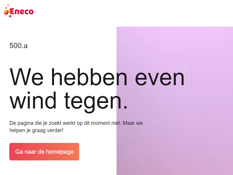

So i thought my password is not changed. Let's try if i can log into https://www.eneco.nl/mijn-eneco/
I can log in. But when i try to see my Overzicht or Verbruik, i get an error page. So i was thinking problems at TOON.
