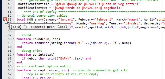

Dear Jos,
I do have the script in the inter editor... [ better for backups etc etc ]
This works with the "older" script good.
Only i did make a change with the config part
I changed to the last beta..
Now i do have a error.. Can you tell me what here is going wrong..

Please show me the whole beginning of the script so I can check if the config part looks ok.
You can also pm it when you prefer.
Jos
Jos

You have commented out the 2 dummy lines for the table and the last line is essential to close the Table syntax with the last }. Just leave them in there as they do serve a purpose!
Jos
afvaltype_cfg = {
["restafval"] ={hour=19,min=01,daysbefore=1,reminder=0,text="Grijze Container met Restafval"},
["gft"] ={hour=19,min=01,daysbefore=1,reminder=0,text="Groene Container met Tuinfval"},
["pmd"] ={hour=19,min=01,daysbefore=1,reminder=0,text="Oranje Container met Plastic en Metalen"},
["kerstbomen"] ={hour=19,min=01,daysbefore=1,reminder=0,text="Kerstbomen"},
["takken"] ={hour=19,min=01,daysbefore=1,reminder=0,text="snoeiafval"},
["papier"] ={hour=12,min=05,daysbefore=0,reminder=0,text="Blauwe Container met Oud papier"},
["plastic"] ={hour=19,min=01,daysbefore=1,reminder=0,text="plastic en drankenkartons"},
["grofvuil"] ={hour=19,min=01,daysbefore=1,reminder=0,text="grofvuil/oud ijzer"},
["tuinafval"] ={hour=19,min=01,daysbefore=1,reminder=0,text="tuinafval"},
-- Add any missing records above this line
["dummy1"] ={hour=02,min=10,daysbefore=0,reminder=0,text="dummy to trigger update for testing"},
["dummy2"] ={hour=02,min=10,daysbefore=0,reminder=0,text="dummy to trigger update of text sensor at night"}}

Derik wrote: Sunday 20 January 2019 21:25jvdz wrote: Sunday 20 January 2019 21:07 Please show me the whole beginning of the script so I can check if the config part looks ok.
JosCode: Select all
-- afvalWijzer module -- -- curl in os required!! -- create dummy text device from dummy hardware with the name defined for: myAfvalDevice -- Check the timing when to get a notification for each Afvaltype in the afvaltype_cfg table -- based on script by zicht @ http://www.domoticz.com/forum/viewtopic.php?t=17963 -- based on script by nf999 @ http://www.domoticz.com/forum/viewtopic.php?f=61&t=17963&p=174908#p169637 ----------------------------------------------------------------- -- file: alvalwijzer_userconfig.lua -- You can define your information in this file without updating the main script eachtime ------------------------------------------------------------------------------------------ myAfvalDevice='D.M.: Afval' -- The Text devicename in Domoticz ShowNextEvents = 2 -- indicate the next x events to show in the TEXT Sensor in Domoticz Postcode='6344AW' -- Your postalcode Huisnummer='29' -- Your housnr NotificationEmailAdress = "[email protected]" -- Specify your Email Address for the notifications. Leave empty to skip email notification Notificationsystem = "" -- Specify notification system eg "telegram/pushover/.." leave empty to skip -- uncoment any of the below when you need to override the standard settings --~ -- Switch on Debugging in case of issues => set to true/false======= --~ debug = false -- get debug info in domoticz console/log --~ -- ### define a line for each afvaltype_cfg retuned by the webrequest: --~ -- hour & min ==> the time the check needs to be performed and notification send when daysbefore is true --~ -- daysbefore ==> 0 means that the notification is send on the day of the planned garbage collection --~ daysbefore ==> X means that the notification is send X day(s) before the day of the planned garbage collection --~ -- reminder ==> Will send a second reminder after x hours. 0=no reminder (needs to be in the same day!) --~ -- text ==> define the text for the notification. afvaltype_cfg = { ["restafval"] ={hour=19,min=01,daysbefore=1,reminder=0,text="Grijze Container met Restafval"}, ["gft"] ={hour=19,min=01,daysbefore=1,reminder=0,text="Groene Container met Tuinfval"}, ["pmd"] ={hour=19,min=01,daysbefore=1,reminder=0,text="Oranje Container met Plastic en Metalen"}, ["kerstbomen"] ={hour=19,min=01,daysbefore=1,reminder=0,text="Kerstbomen"}, ["takken"] ={hour=19,min=01,daysbefore=1,reminder=0,text="snoeiafval"}, ["papier"] ={hour=12,min=05,daysbefore=0,reminder=0,text="Blauwe Container met Oud papier"}, ["plastic"] ={hour=19,min=01,daysbefore=1,reminder=0,text="plastic en drankenkartons"}, ["grofvuil"] ={hour=19,min=01,daysbefore=1,reminder=0,text="grofvuil/oud ijzer"}, ["tuinafval"] ={hour=19,min=01,daysbefore=1,reminder=0,text="tuinafval"}, --~ -- Add any missing records above this line --~ ["dummy1"] ={hour=02,min=10,daysbefore=0,reminder=0,text="dummy to trigger update for testing"}, --~ ["dummy2"] ={hour=02,min=10,daysbefore=0,reminder=0,text="dummy to trigger update of text sensor at night"}} --~ -- Define the Notification Title and body text. there are 3 variables you can include: --~ -- @DAG@ = Will be replaced by (vandaag/morgen/over x dagen) --~ -- @AFVALTYPE@ = Will be replaced by the AfvalType found on the internet --~ -- @AFVALTEXT@ = Will be replaced by the content of the text field for the specific AfvalType in afvaltype_cfg --~ -- @AFVALDATE@ = Will be replaced by the pickup date found on the internet notificationtitle = '@AFW: @DAG@ de @AFVALTEXT@ aan de weg zetten!' notificationtext = '@DAG@ wordt de @AFVALTEXT@ opgehaald!' --==== end of config ====================================================================================================== -- General conversion tables local MON_e_n={January="januari", February="februari", March="maart", April="april", May="mei", June="juni", July="juli", August="augustus", September="september", October="oktober", November="november", December="december"} local WDAY_e_n={Sunday="zondag", Monday="maandag", Tuesday="dinsdag", Wednesday="woensdag", Thursday="donderdag", Friday="vrijdag", Saturday="zaterdag"} local MON={januari=1,februari=2,maart=3,april=4,mei=5,juni=6,juli=7,augustus=8,september=9,oktober=10,november=11,december=12} -- round break break
MM Thanks!!
The red cross in gone..
So i hope this works again..
Postcode='6678AW' -- Your postalcode
Huisnummer='1' -- Your housnr
afvaltype_cfg = {

return commandArrayThere is something going on..
Only he says no thing to do?
2019-02-02 20:42:05.787 Status: LUA: @AFW:afvaltype_cfg :plastic;19;1
2019-02-02 20:42:05.787 Status: LUA: @AFW:afvaltype_cfg :restafval;19;1
2019-02-02 20:42:05.787 Status: LUA: @AFW:afvaltype_cfg :pmd;19;1
2019-02-02 20:42:05.787 Status: LUA: @AFW:afvaltype_cfg :gft;19;1
2019-02-02 20:42:05.787 Status: LUA: @AFW:afvaltype_cfg :dummy2;2;10
2019-02-02 20:42:05.787 Status: LUA: @AFW:afvaltype_cfg :grofvuil;19;1
2019-02-02 20:42:05.787 Status: LUA: @AFW:afvaltype_cfg :tuinafval;19;1
2019-02-02 20:42:05.787 Status: LUA: @AFW:afvaltype_cfg :papier;12;5
2019-02-02 20:42:05.787 Status: LUA: @AFW:afvaltype_cfg :takken;19;1
2019-02-02 20:42:05.787 Status: LUA: @AFW:afvaltype_cfg :kerstbomen;19;1
2019-02-02 20:42:05.787 Status: LUA: @AFW:Scheduled time(s) not reached yet, so nothing to do! Xu4: Beta Extreme antenna RFXcomE,WU Fi Ping ip P1 Gen5 PVOutput Harmony HUE SolarmanPv OTG Winddelen Alive ESP Buienradar MySensors WOL Winddelen counting RPi: Beta SMAspot RFlinkTest Domoticz ...Different backups
- jvdz
- Posts: 2492
- Domoticz version: 4.107
Re: Sharing : Afval kalendar in text sensor
The script will run each minute but It will only do something when one of the times in the table is equal to the actual time.
You have commented the debug=false line so it is showing the extra information like you see in the log.
You should actually not comment that line but change it to debug = true when you want to see the extra debugging information.
All clear?
Jos
All clear?
Jos
Derik
- Posts: 1605
- Domoticz version: BETA
yes...
Only the script is not working any more...
The garbage days are not changing?
- jvdz
- Posts: 2492
Ok, then show me the generate log when a the time it does the update process, so one of the times in the table is the actual time.
You can force this by using one of the dummy lines.
Jos
Jos
Derik
- Posts: 1605
Time.. in the table?jvdz wrote: Sunday 03 February 2019 9:44 Ok, then show me the generate log when a the time it does the update process, so one of the times in the table is the actual time.
Jos
The script is running every ,minute...
And the force part i do not understand?
- jvdz
- Posts: 2492
I know it is running every minute, but as I explained, it doesn't check the data on the website until one of the times in the table is equal to the current time!
Anyways, I looked at the posted code and that looks like an OLD version of the script and not the most recent version on GitHub, which indeed will not run properly in some cases.
Use that latest version from GitHub, update the info at the top and you should be good to go.
https://github.com/jvanderzande/mijnafv ... wijzer.lua
Jos
Jos
