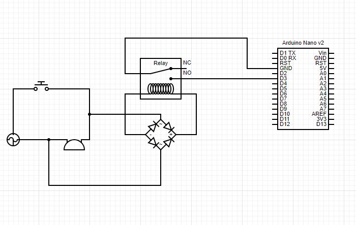

Something like this
instead of GND you can use +5 I prefer using the internal pull up and then to GND

freijn wrote: Monday 28 January 2019 9:53 Something like this
Maybe add a capacitor over + and -. Now you get a 100Hz signal on your relay
