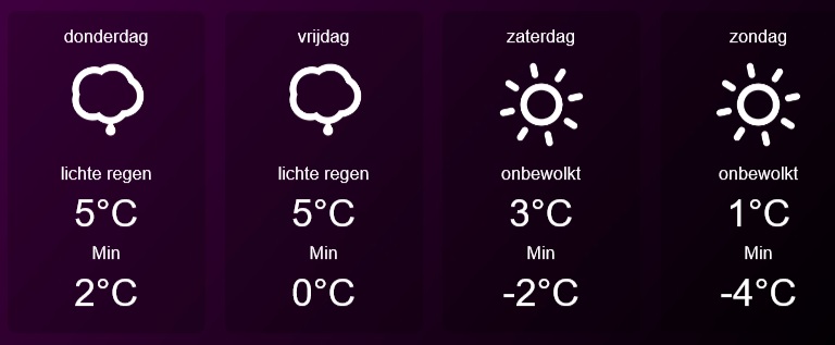

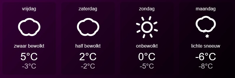

jake wrote: Monday 14 January 2019 0:06 Feature request, the given temperature is an average, it would be nice to have the min temperature of the day as an option on a 2nd row.
Your wish is my command :D
Daily forecast with minimum.jpg (42.09 KiB) Viewed 3242 times
I implemented it in the new version of the file weather_owm.js (Dashticz version 2.5.2)
But it can also be used in 2.5.1
Please test the code. As with the previous, this is not the official Dashticz file.
Make a backup of your weather_owm.js file and overwrite the content with the code below

There is also a new option, owm_min.
config['owm_api'] = 'xxxxxxx'; 		// Your OWM API key
config['owm_city'] = 'Amsterdam';	// Your city or nearby city to use in OWM
config['owm_name'] = '';		// If your city is not available with OWM, you have to use a nearby city. You can type the name of your own city here to show it in Dashticz
config['owm_country'] = 'nl';		// Your country to use in OWM
config['owm_cnt'] = 4;			// Number of columns to show. If showing days, max is 5, (4 is recommended )
config['owm_days'] = 1;			// Enter 1 for showing forecast in days, 0 for the OWM default 3 hour forecast
config['owm_min'] = 1;			// Enter 1 to show min temperature on 2nd row
config['owm_lang'] = 'nl';		// Set language for de description of the forecast (rain, cloudy, etc.). For available languages, see https://openweathermap.org/forecast5/#multi
config['static_weathericons'] = 0;	// Enter 1 for animated weather icons, 0 for static icons

jake wrote: Thursday 17 January 2019 7:53 By looking in the topic 'show your dashboard' I saw that with WU the min temperature was a smaller font, a less prominent color and that the word 'min' wasn't there. Altogether a nice solution to save height in the block.
Thanks, that put me on the right track. I changed the code so it looks like this now:
Daily forecast with minimum small.jpg (37.83 KiB) Viewed 3208 times

@toro: Thanks. If I choose for default 3 hour forecast the temp and rain are on the same row without space.
I think a break will make it more readable.
html += '<div class="temp"><span class="av_temp">' + Math.round(temp) + _TEMP_SYMBOL + '</span><br /><span class="rain">' + (Math.round(rain*100)/100) + " mm" + '</span></div>';

@HansieNL: You are right, that looks a lot better. So here's the complete code

jake wrote: Thursday 31 January 2019 15:22 Based on the weather description the individual forecast days may have a different height, by either using 1 or 2 lines (rain versus light snow for instance).
This has an impact on the blocks underneath the weather forecast. Depending on the 1st,2nd,3rd,4th day, it throws the blocks beneath down, or start a block after the day with double line text.
Long story short, it would be nice if the block height always takes 2 text lines into account for the weather description, whether used or not.

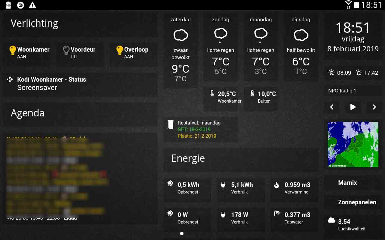

I now was able to take a screenshot of my tablet. Normally, when all 4 weather boxes have the same size, the 'woonkamer' block would start underneath 'zaterdag'. Since the forecast takes 2 lines for that sub block only, the temperature block starts below 'zondag'.
The result is that the garbage block ends up on the next line, ruining that whole column setup.
(woonkamer width =3, buiten width = 3 and garbage width = 6, making 12 to fill a column)
The bottom 3 blocks are not visible right now, but by halfway tomorrow they will, because then Saturday will be gone for the weather forecast and (hopefully) 4 sub blocks of equal height will remain.
