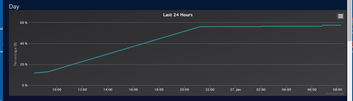

I get the same error
2019-01-26 14:04:19.060 Error: (Hive): Async Secure Read Exception: 1, stream truncated
2019-01-26 14:04:19.309 Error: (Hive) 'onMessage' failed 'KeyError'.
2019-01-26 14:04:19.309 Error: (Hive) ----> Line 860 in '/home/pi/domoticz/plugins/domoticz-hive/plugin.py', function onMessage
2019-01-26 14:04:19.309 Error: (Hive) ----> Line 155 in '/home/pi/domoticz/plugins/domoticz-hive/plugin.py', function onMessage
2019-01-26 14:04:19.309 Error: (Hive) ----> Line 481 in '/home/pi/domoticz/plugins/domoticz-hive/plugin.py', function UpdateDeviceState
2019-01-26 14:04:19.310 Error: (Hive): Async Secure Read Exception: 1, stream truncated
Domoticz V4.10365
Python version '3.5.3
Also the memory usage increases.
Pi rebooted at around 09:00, plugin disabled around 21:00
Memory Test.JPG (36.98 KiB) Viewed 2134 times
