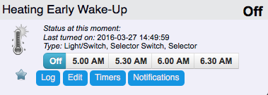

This seems to be working pretty well now if anyone has the same requirement. I wanted an ad-hoc early wake-up in Hive since I couldn't find a way to make a one-off early start using their own app or website. This seems to cover it for me.
This switch allows me to pre-select the early wake-up time...
