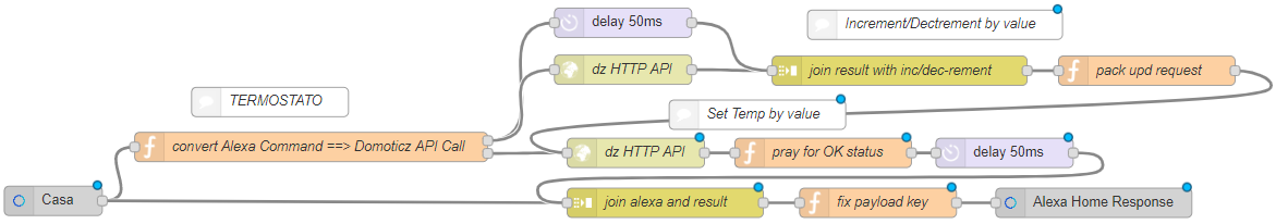

for thermostat I've done it with NodeRed and Alexa-Home-Skill
it tooks me a while... but it's working good now
