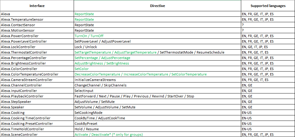

Please note that the skill can only works with Alexa interfaces as described in the following tab :
Sans titre.png (35.02 KiB) Viewed 24155 times
It's therefore not possible to get power consumption of any kind as Alexa does not support this functionality yet.

@mvzut :
>> Will look for Contact...
>> Status for light ; that feature is not supported by Amazon / Alexa. You can check the Amazon Light interface which supports only the following commands :
- Turn a light on or off
- Set the power level of an endpoint
- Change the brightness of a light by percentage or to a specific value
- Change the color of a light
- Change the shade of white for a tunable light
whereas the Amazon Contact interface should support status command.

Regarding the "Contact", i got some documentation here :
https://developer.amazon.com/docs/devic ... faces.html
and the only supported language/locale for the Alexa.ContactSensor Interface is now : EN-US...
Looking at the same documentation, it seems that Amazon is now supporting "DZ Selector Switch" with the "Alexa.ModeController" but it's also restricted to EN-US locale.
Well... we have to work a little bit on the code... and trueblueswede would be happy since he changed its locale to EN-US ^^

Damsee wrote: Saturday 08 December 2018 15:53 Regarding the "Contact", i got some documentation here :
Dear all,
We manage to change the code of the skill which is available on GIT : https://github.com/rimram31/dz_smarthome for the CONTACT_SENSOR.
As we do not have any contact devices, we didn't test the new functionality but feel free to give your feedbacks in the forum.
Enjoy :D
