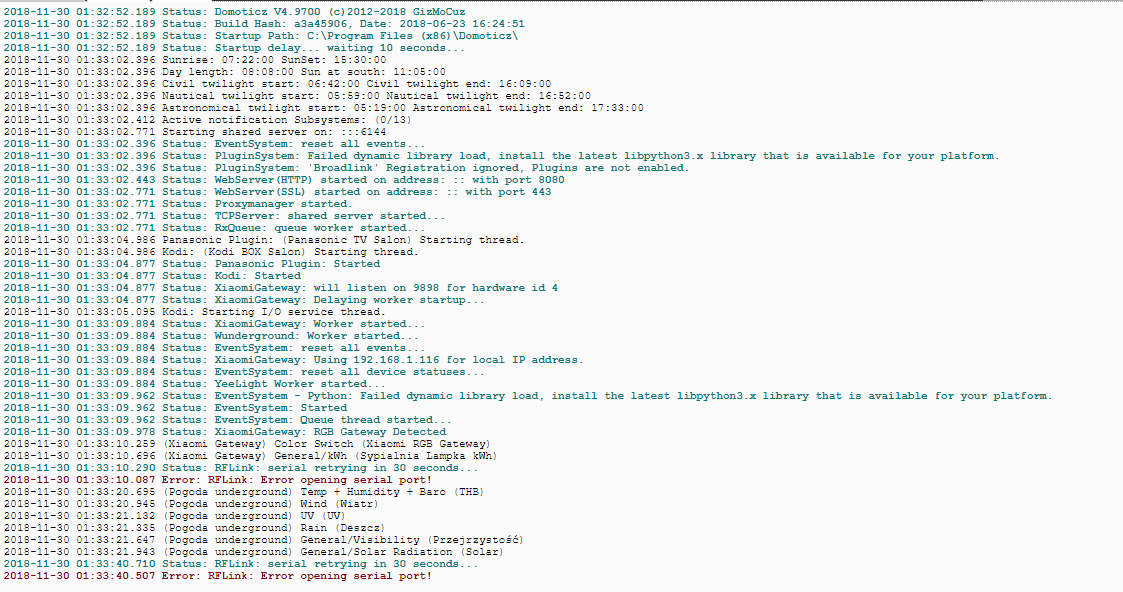

Hi all, I'm new and trying to make this plugin work.
Using Win 10 and latest stable app
Im currently stuck with the message
"Error: (BroadlinkRM2) failed to load ' plugin.py', Python Path used was ..."
I tried to install and uninstall different Python versions, only 3.4
Let me install the plugin since crypto demanded it...but from.that step, I get the error above...
Any clue?
Thanks ms for any help

adirc wrote: Sunday 18 November 2018 15:44 Hi all, I'm new and trying to make this plugin work.
Any clue?
if you go to domoticz / about let show what you have.

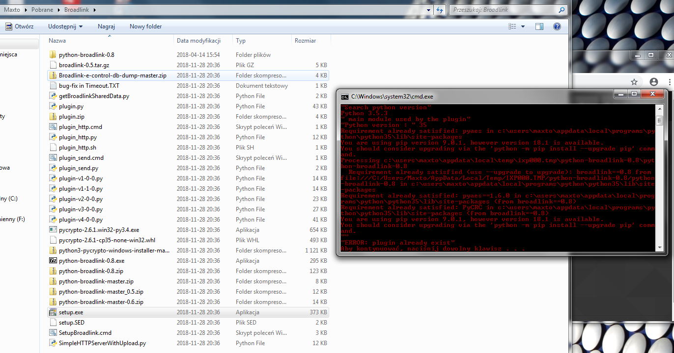

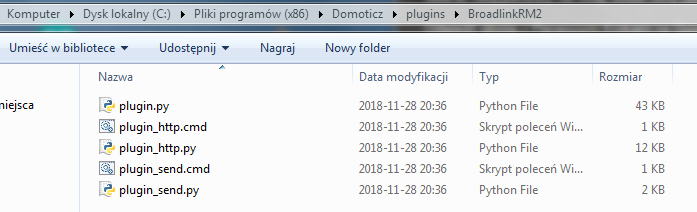

Here log after restart domoticz
hose2001
Posts: 6
Joined: Thursday 30 August 2018 0:00
Re: Python Plugin : Broadlink RM2 V4
Post by hose2001 »
hose2001 wrote: Thursday 29 November 2018 0:30
hose2001 wrote: Wednesday 28 November 2018 23:50 Hey zak45,
I see that You have domoticz on windows.
I really want your plugin to work stably on domoticz, that's why I changed the system. I have a problem installing your plugin on windows. I installed python 3.5.3 and when I run setup.exe as an administrator, I have such an error. I copied files to C: / ProgramFiles x86 / Domoticz / plugins / BroadlinkRM2. I have no broadlink on the device list. I'm sorry but I've used domoticz on raspberry / raspbian before and I'm a bit lost here.
Can you help and write a detailed installation guide?
Thank you in advance
Ok work I must install python 3.5.3 but x86 version (I foud this info on forum in Broadlink RM v3 topic) and today morning still working yupii :D.
