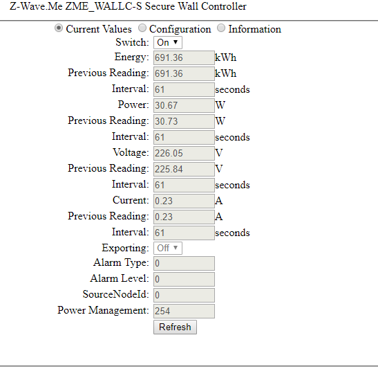

could you post a screenshot of the openzwave control panel ? does this sensor report kva also ?

Here is a screenshot of the OpenZwave configuration panel for the concerning device. Not sure how I can see if it reports kVa.
I am not experiencing any issues with my other Neo Coolcam plugs. I have 8 of them and some fibaro's.
Actually I did a factory reset of the plug a few minutes ago, will let you know if this solves the problem.
OpenZWave Control Panel.png (36.05 KiB) Viewed 592 times
