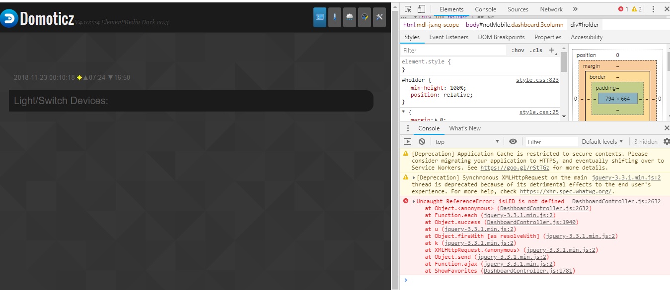

Greetings to all. I ran into a problem. There are no sensors and information in the dashboards in the normal and compact modes.
On the dashboard, sensors are displayed only in the mobile mode.
I cleaned the cache, used different browsers, reset the default theme settings, used other themes, nothing helps.
When viewing the source code in the browser errors are displayed:
DashboardController.js:2632 Uncaught ReferenceError: isLED is not defined
at Object.<anonymous> (DashboardController.js:2632)
at Function.each (jquery-3.3.1.min.js:2)
at Object.success (DashboardController.js:1940)
at u (jquery-3.3.1.min.js:2)
at Object.fireWith [as resolveWith] (jquery-3.3.1.min.js:2)
at k (jquery-3.3.1.min.js:2)
at XMLHttpRequest.<anonymous> (jquery-3.3.1.min.js:2)
at Object.send (jquery-3.3.1.min.js:2)
at Function.ajax (jquery-3.3.1.min.js:2)
at ShowFavorites (DashboardController.js:1781)-

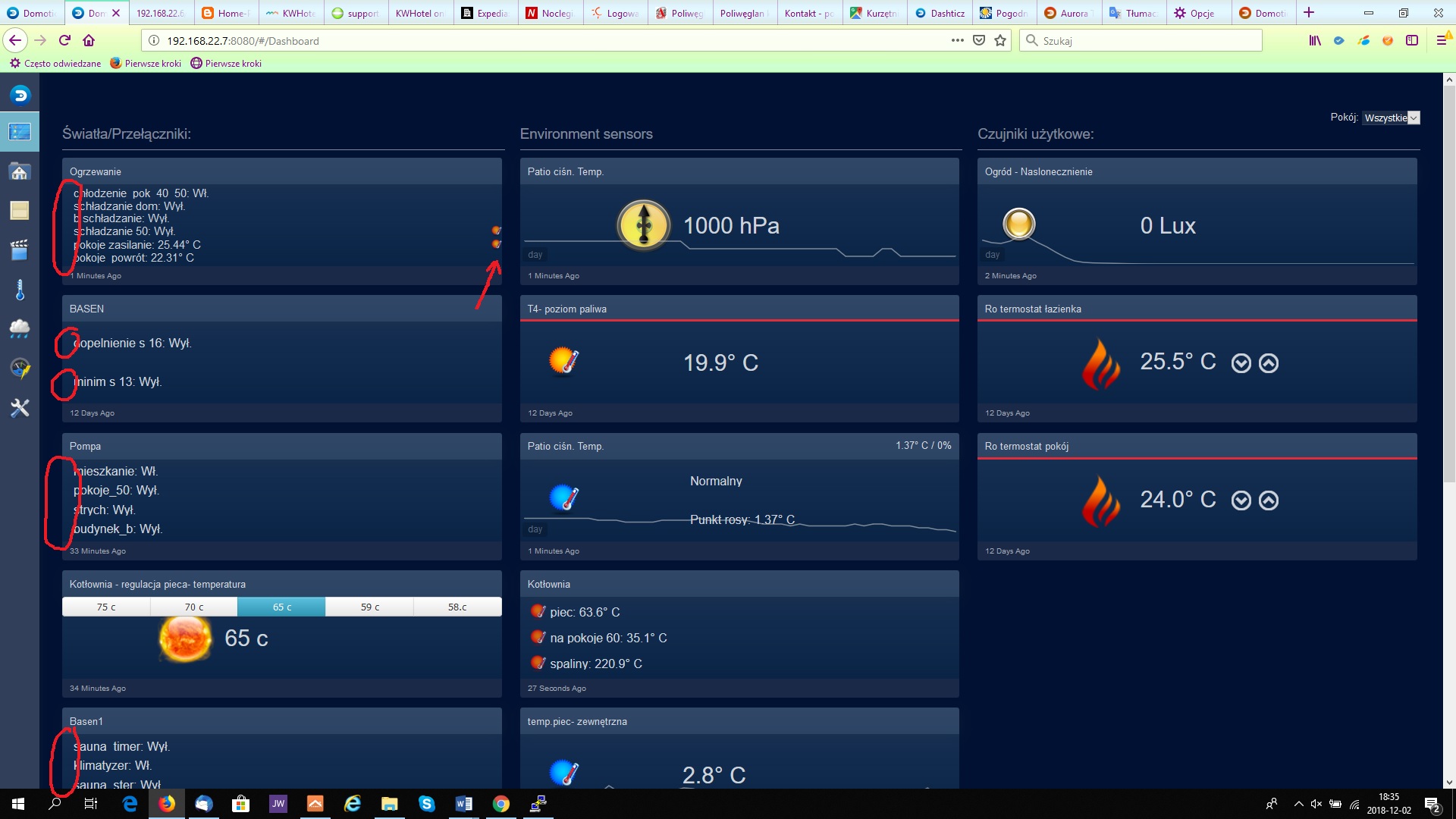

Hi Guys,
i have a question, couldent find something via the search function.
How can i manage, that all icons/sensors are showing the datavisualization below the temperature?
Default setting is 3? If yes can i increase the number somewhere in a config file?
I marked the sensors with a red line, where i like to see the visualization as well.
Many thanks in advance
BR/mauip

Full reinstallation of domoticz solved the problem !NiCOOLaS wrote: Thursday 22 November 2018 22:24 There are no sensors and information in the dashboards in the normal and compact modes.
Make backup, then:
service domoticz stop
delete folder: /pi/domoticz
delete folder: /etc/domoticz
delete folder: /etc/init.d/domoticz.shDone

@maulp: thins question comes up from time to time. Currently the three are hardcoded. I'm not sure, but I think there's a way to get dataviz everywhere if you go for compact view and disable the 'three highlights' feature. Can you test this?

I created a new feature.
You can now make all items 'highlighted'. This makes them all big.
This means they can all have data visualization on them.
You can still merge these items too, but please don't merge too many as they won't fit. Dataviz then won't work on merged items.
All switches can now have a camera image attached to them too, not just the first three. This turns Domoticz into a very basic camera surveillance system

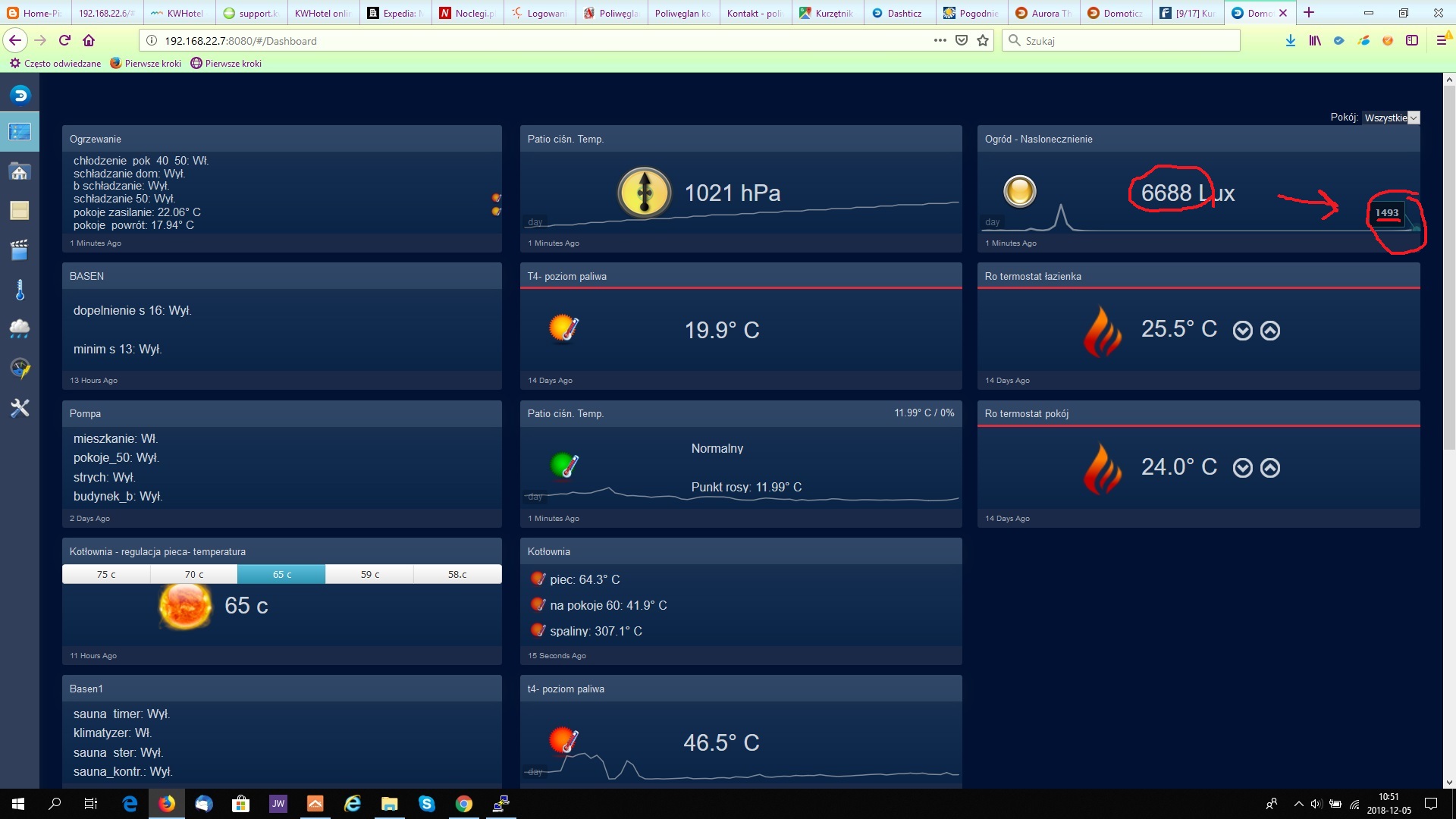

welcome back. another mistake I have is the lack of chart refreshing.
the sensor shows different data and it has been created since the last time the page was opened in the browser.
regarding the system:
domoticz has been installed on
Raspbian Stretch Lite
Version: November 2018
Release date: 2018-11-13
maybe this data will help something ...
