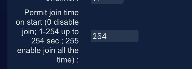

Are you sure when you start the Plugin you set the Permit To join to a value like 250 or 255 ? in order to allow you zigbee devices to be paired ?
Screenshot 2018-11-08 at 21.23.04.png (32.55 KiB) Viewed 2865 times

Yes it is set to 255.

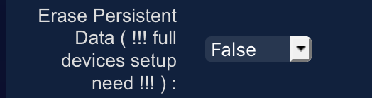

And when you'll start the plugin please do ERASE PDM

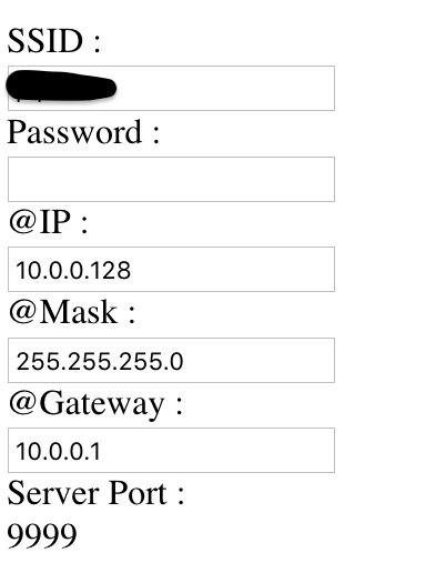

What do you mean, you are not able to login ? You are not able to reach this menu ?
Screenshot 2018-11-11 at 19.27.33.png (34.88 KiB) Viewed 2743 times
As-tu essayé d'y accèder à l'adresse http://192.168.4.1 en t'associant à l'AccessPoint comme indiqué https://zigate.fr/getting-started/

No thats not it.
I cannot connect to the wifi module in AP mode anymore (to SSID ZIGATE-XXXX).
Password is correct though.
Depending on the device I try with I get Incorrect password and/ or cannot connect to this network.
So I cannot configure the module to connect to my Wifi network.

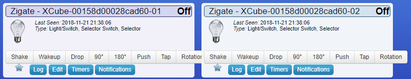

The Aquara wall switch (the flat battery driven one) is detected wrongly I think since Domoticz thinks it is a XCube and it creates 2 devices.
Also pressing a button on the switch creates a python error in the log.

hkhk wrote: Wednesday 21 November 2018 22:06 The Aquara wall switch (the flat battery driven one) is detected wrongly I think since Domoticz thinks it is a XCube and it creates 2 devices.
While looking into your log, I saw that the model is : lumi.remote.b186acn01, I would appreciate if you could give me more details:
- reference of this switch
- number of switch
- expected behaviour
