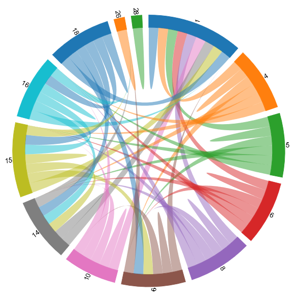

You can also verify if this works as it should by checking Setup/Hardware and click on Setup for the Zwave controller and under Node Management/Groups & Network which would provide you a map of the mesh network:

In my case it looks like this. Node ID 28 is a newly added light switch. Nodes 18 and 26 are door locks. Node 18 was last time seen on 30.09. Before that time it worked and I got configured notification. Unfortunately it stopped for a reason unknown to me.
Nodes 20-25 are previous instances of the current node 26. I've factory reset and re-included it.
