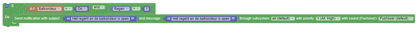

I've got a problem with this blocky script, somehow the rain-sensor does not trigger anything. It's the rain-sensor from Weather Underground. Can somebody help me? Thanks in advance!

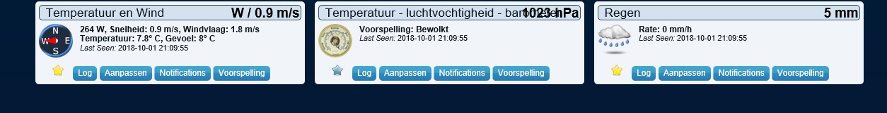

Well, it is definitely not working. Somehow it seems that domoticz isn’t “grabbing” the data from Weather Underground properly.

Working fine here too, we had a few showers yesterday and they popped up in WU/Domoticz. Maybe you selected a station without rain?

Unfortunately still not working. WU gives the amount of rain. But Blocky does not do anything.
The attachment wu_rain_domo.jpg is no longer available
The regen_switch (which is a dummy) does not switch.

Balkondeur is a real contact? Then it should be Open instead of On

Try to first write a log entry when you expect rain is there, so only on the Regen > 1. Kind of debugging, then see what happens. Maybe as SweetPants suggested the problem lays somewhere else
