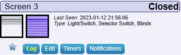

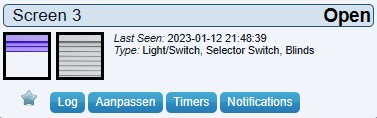

How is it implemented for blinds?
Usercase:
The blinds can be opened and closed from Domoticz as well as from the Shelly app.
If the blinds are closed using the Shelly app the blinds will still show open in Domoticz.
The Domoticz switch issues the command:
http://192.168.1.142/roller/0?go=open , not the Domoticz Json command
Can the the appearance of the blinds switch be toggled without firing the blinds using the update command?

Well....
I've spent half a day spilling time, enjoying to program.
Little has come out of it.
 2023-01-12 19:00:00.347 Status: dzVents: Info: test: ------ Start internal script: test:, trigger: "every minute"
2023-01-12 19:00:00.365 Status: dzVents: Debug: test: Processing device-adapter for Screen 3: Switch device adapter
2023-01-12 19:00:00.365 Status: dzVents: Info: test: here we are at the start of the function
2023-01-12 19:00:00.365 Status: dzVents: Info: test: Closed
2023-01-12 19:00:00.365 Status: dzVents: Info: test: Screen 3 is Closed
2023-01-12 19:00:00.365 Status: dzVents: Info: test: ------ Finished test
2023-01-12 19:00:00.365 Status: EventSystem: Script event triggered: /home/pi/domoticz/dzVents/runtime/dzVents.lua
2023-01-12 19:01:00.359 Status: dzVents: Info: test: ------ Start internal script: test:, trigger: "every minute"
2023-01-12 19:01:00.376 Status: dzVents: Debug: test: Processing device-adapter for Screen 3: Switch device adapter
2023-01-12 19:01:00.376 Status: dzVents: Info: test: here we are at the start of the function
2023-01-12 19:01:00.376 Status: dzVents: Info: test: unforeseen situation
2023-01-12 19:01:00.377 Status: dzVents: Info: test: ------ Finished test
The above log shows that one can influence the properties of a Blinds switch, one cannot change it from Open to Close or the other way round.
One can 'empty' the switch.

You can test for yourself by creating a dummy switch which you can transform to a blinds switch.
It doesn't have to have a relationship with any existing device.
The positive side of this that I now can check the answer the Shelly device gives me and when that answer is not equal to the Domoticz state of the device one can make the switch aspect change to empty.
BTW
The silent() option triggers action
EDIT
After struggling many hours and publishing the above text I tried one last.
quietOn() and quietOff
That's it, nothing more, nothing less

            -- Can be domoticz.LOG_INFO, domoticz.LOG_MODULE_EXEC_INFO, domoticz.LOG_DEBUG or domoticz.LOG_ERROR
            -- marker: A string that is prefixed before each log message.
             level = domoticz.LOG_INFO and domoticz.LOG_DEBUG,
            --level = domoticz.LOG_INFO,
            marker = "test",
	    execute = function(dz, item)
	        local screen_state = dz.devices(SCREEN_3).state
            dz.log('Switch state before testing', dz.LOG_INFO)
            dz.log(screen_state, dz.LOG_INFO)
            if screen_state == 'Closed' then
                dz.log('Before switching state', dz.LOG_INFO)
                dz.log(dz.devices(SCREEN_3).state, dz.LOG_INFO)
			    dz.devices(SCREEN_3).quietOn()   -- quietOn equals open
                dz.log('After switching state', dz.LOG_INFO)
	        elseif (screen_state == 'Open') then
			    dz.devices(SCREEN_3).quietOff()   -- quietOn equals open
			elseif (screen_state ~= 'Closed') or (screen_state ~= 'Open') then
			    dz.log('unforeseen situation', dz.LOG_INFO)
Domoticz cannot handle the second call for the switch state.
The second
gives the same output as the first whilst the view of the switch Open or Close actually has changed (has been toggled)
The log:
 2023-01-12 22:47:00.548 Status: dzVents: Info: test: ------ Start internal script: test:, trigger: "every minute"
2023-01-12 22:47:00.565 Status: dzVents: Debug: test: Processing device-adapter for Screen 3: Switch device adapter
2023-01-12 22:47:00.565 Status: dzVents: Info: test: Switch state before testing
2023-01-12 22:47:00.565 Status: dzVents: Info: test: Open
2023-01-12 22:47:00.565 Status: dzVents: Info: test: Before switching state
2023-01-12 22:47:00.565 Status: dzVents: Debug: test: OpenURL: url = http://127.0.0.1:8383/json.htm?type=command&param=udevice&nvalue=0&svalue=0&idx=33
2023-01-12 22:47:00.565 Status: dzVents: Debug: test: OpenURL: method = GET
2023-01-12 22:47:00.565 Status: dzVents: Debug: test: OpenURL: post data = nil
2023-01-12 22:47:00.565 Status: dzVents: Debug: test: OpenURL: headers = nil
2023-01-12 22:47:00.565 Status: dzVents: Debug: test: OpenURL: callback = nil
2023-01-12 22:47:00.565 Status: dzVents: Info: test: After switching state
2023-01-12 22:47:00.565 Status: dzVents: Info: test: ------ Finished test
Bugs bug me.
