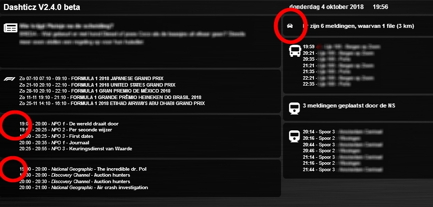

I found 2 cosmetic bugs:
1. Icon of redefined block traffic smaller than rest of icons (beta 2.4.0) https://github.com/Dashticz/dashticz_v2/issues/383
The icon of redefined block traffic is smaller than other predefined icons.
If I change <em class="fa fa-car"></em> to <em class="fas fa-car"></em> the icon has size of other predefined icons.
2. TV Guide icon not shown in TV Guide block (beta 2.4.0) anymore https://github.com/Dashticz/dashticz_v2/issues/382
The TV Guide icon is not shown in the TV Guide block in beta 2.4.0 anymore.
This icon is shown in master 2.3.3.
If I change <em class="fa-television"></em> to <em class="fas fa-tv"> the icon is shown, but doesn't resize well.
I don't know how to fix these cosmetic bugs... Is there someone who can fix them and send a pull request?
FIXED IN LATEST BETA

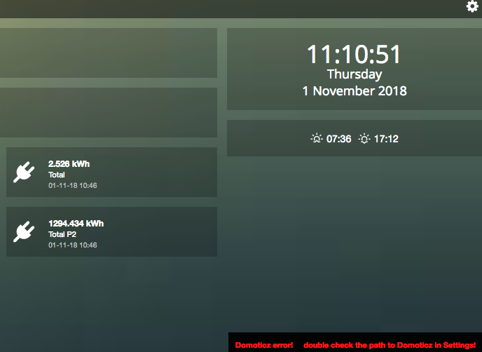

I recently got this dashboard but i can not change/save settings and i can not move sliders on my screen.
The error i get is in the bottom right corner that i have to check the path to domoticz which is weird because i do see my switches.
chmod 777 CONFIG.js didnt do the trick so it ain't a permission error.
- Screen Shot 2018-11-01 at 11.10.45.png (83.53 KiB) Viewed 6197 times
Lokonli
- Posts: 2296
Re: Dashticz - Bug report
If you want to change the blocks on the screen then you have to edit CONFIG.js by hand. See the WIKI https://www.domoticz.com/wiki/Dashticz_V2 or this forum on how to do that. The Edit mode within Dashticz is not working.RapTile wrote: Thursday 01 November 2018 11:14 I recently got this dashboard but i can not change/save settings and i can not move sliders on my screen.
For saving the config settings from the Dashticz -> settings window you must have a web server running with PHP enabled, for instance Apache. The Domoticz web server doesn't support PHP. See the installation instructions in the WIKI for more information.
For some reason i can not get php7.0-curl installed.
I've updated the list with "sudo apt-get update" but when i do "sudo apt-get install php7.0-curl" i get the error:
E: Unable to locate package php7.0-curl
Any idea's?

I managed to get this working with this manual:RapTile wrote: Thursday 01 November 2018 13:04
Thanks for the info.
Any idea's?
https://www.stewright.me/2016/03/turn-r ... eb-server/

Thanks! I'll add the link to the Wiki.RapTile wrote: Thursday 01 November 2018 15:03I managed to get this working with this manual:RapTile wrote: Thursday 01 November 2018 13:04
