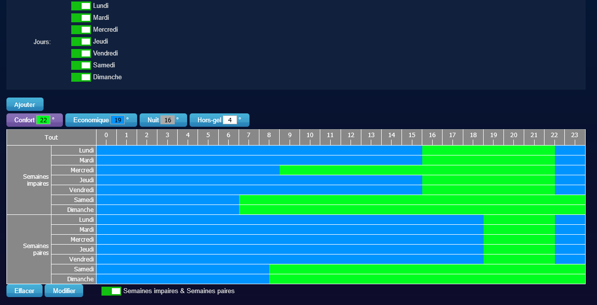

New update!
I edited the first post with new screen capture
- you can choose time range : 1h, 30mins, 15mins, 10mins
- deactivate the entire "program" (stand by mode) and activate it later
- program on 2 weeks with the odd&even mode
Source on github https://gist.github.com/syrhus/8fbb01fb ... be210993c8
