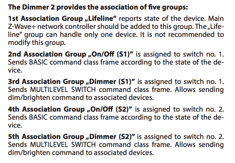

Thanks for the guidance. I think I understand what you mean. I have a Fibaro Dimmer
https://manuals.fibaro.com/content/manu ... T-v1.3.pdf
According to the manual I should add it to group 1:

The controller needs to be in that "lifeline" group to receive the status. Just add that in there and check.
Jos

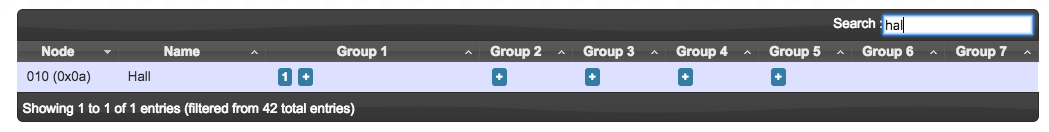

Sorry, let's try with bigger pictures.
I want to add this (which is already on group1)
Screen Shot 2018-09-12 at 17.13.31.png (22.47 KiB) Viewed 1132 times
to report status to the controller

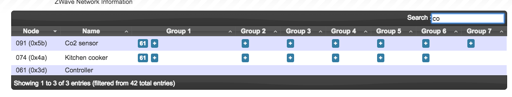

So lets take de Hall. It has in Group1 the device 1 ( did you replace your controller that had deviceid 1 at the time?)
This group1 needs to contain the deviceid of your current controller, so should be 61.
There is no need to add anything to the controller itself, only to each device you want to control and receive the status for!
So when this work for Hall, you need to check/update all ZWAVE devices.
By the way: the CO2 sensor and Kitchen do have the proper value there (61) so guess they work fine?
Any clearer?

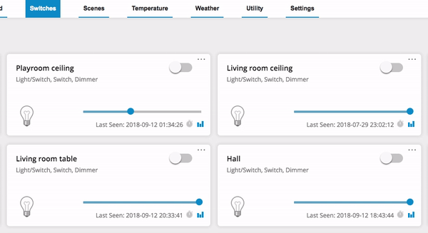

Hey! It turns it actually works!
Thanks so much for the clarification, I never quite understood what the groups did so my Z-wave network was a real mess :oops: . Manually updated it now :)
I guess the same applies for an alarm, right? so If I have a device alarm ID37, and I want a door to send a signal to it when open, then I would add it to group 37, right?
Anyway, the reporting work great now, updated from manual switch on Domoticz ;)
