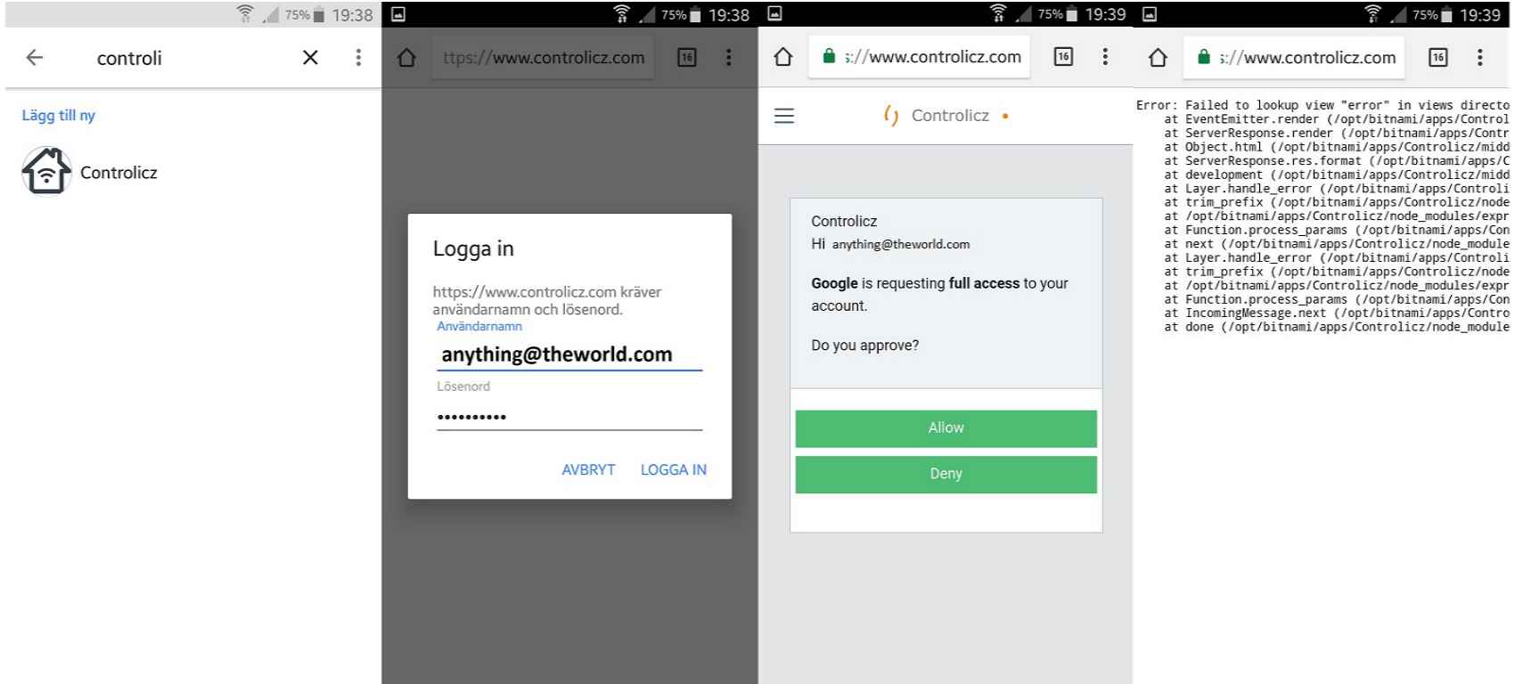

Whats is this for kind of error. It appears when I'm going to link to my Google home device.
I have paid for monthly subscription.
Error: Failed to lookup view "error" in views directory "/opt/bitnami/apps/Controlicz/views"
at EventEmitter.render (/opt/bitnami/apps/Controlicz/node_modules/express/lib/application.js:580:17)
at IncomingMessage.next (/opt/bitnami/apps/Controlicz/node_modules/express/lib/router/index.js:275:10)
at done (/opt/bitnami/apps/Controlicz/node_modules/express/lib/response.js:1003:25)
If You ever get an error like this when trying to link Google Home with Controlicz You probably got an cache issue.
It happens at the end of the process of linking your Google Account to Controlicz.
Then try clearing your cache on the current browser on your mobile phone or tablet that you are using for implement the link.
How To Clear cache & cookies on Chrome https://support.google.com/accounts/ans ... roid&hl=en
Thanks to Nick Madge for pointing me in the right direction to find the problem.
