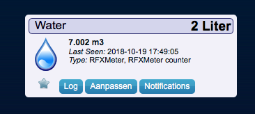

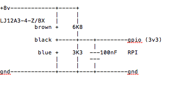

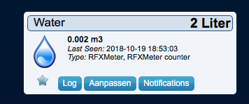

I've a problem to read good values from my NPN-sensor (https://nl.aliexpress.com/item/Free-Shi ... 4c4dzOHtIO.
I connect it like this:
Schermafbeelding 2018-10-19 om 17.58.53.png (16.78 KiB) Viewed 3213 times
I use this script:

If I start my script and when I go past the sensor with my screwdriver I get this back:
Callback function called!
quitting event handler because this was probably a false positive
JSON call = http://10.0.1.88:8080/json.htm?type=command&param=udevice&idx=17&svalue=14
Watermeter Counter = 14
JSON call = http://10.0.1.88:8080/json.htm?type=command&param=udevice&idx=17&svalue=15
Watermeter Counter = 15
JSON call = http://10.0.1.88:8080/json.htm?type=command&param=udevice&idx=17&svalue=16
Watermeter Counter = 16
JSON call = http://10.0.1.88:8080/json.htm?type=command&param=udevice&idx=17&svalue=17
Watermeter Counter = 17
JSON call = http://10.0.1.88:8080/json.htm?type=command&param=udevice&idx=17&svalue=18
Watermeter Counter = 18
I get some input in my RFXMeter sensor in Domoticz (V4.10007) but this is very irregular and goes up but also down. These are not reliable values.
In the file: meterstand_water.txt I only see: ' meterstand = 21'.
What can be the problem?
Schermafbeelding 2018-10-19 om 18.53.17.png (26.65 KiB) Viewed 3209 times
Schermafbeelding 2018-10-19 om 18.06.52.png (27.02 KiB) Viewed 3210 times

remko2000 wrote: Friday 19 October 2018 18:07 I connect it like this:
The problem with this circuit is that your 3k3 resistor will be in parallel with the input resistance of the GPIO pin when you connect it up. This means that your voltage divider will not be very stable, nor will it divide by the ratio you expect. It's much safer to use either a FET as a level-shifter, or use a zener diode. Both approaches are explained in earlier posts in this thread.
Alexa skills author: EvoControl, Statereport, MediaServer, LMS-lite
