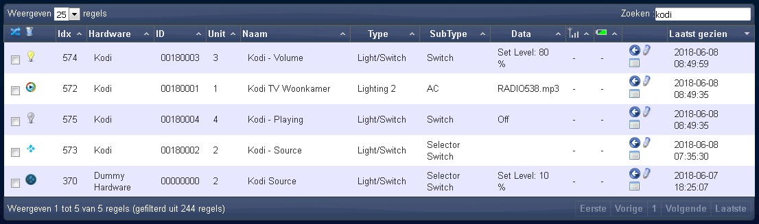

So I changed my scripts. The "Trigger" Favorites works great.
But the Volume doesn't. That command isn't changed:
commandArray['Kodi TV Woonkamer'] = 'Set Volume 100'
The Log says it works:
2018-06-07 18:17:20.530 (Kodi) onCommand called for Unit 1: Parameter 'Set Volume', Level: 100, Connected: True
Using the manual remote control you can change the volume.
2018-06-07 19:00:23.003 (Kodi) Update 2:'80' (Kodi - Volume)
2018-06-07 19:00:23.446 (Kodi) Update 2:'82' (Kodi - Volume)
Am I doing something wrong?

@Brutus,
You are sending the command to the wrong device. The plugin creates 4 devices , one of them is the 'Volume' device (Unit #3). Assuming ''Kodi TV Woonkamer" is what you named the hardware then try:
commandArray['Kodi TV Woonkamer - Volume'] = 'Set Volume 100'
If you renamed the 'Volume' device to something else you will obviously need to use its new name
You should see some thing like this in the log:
2018-06-07 18:17:20.530 (Kodi) onCommand called for Unit 3: Parameter 'Set Volume', Level: 100, Connected: True
Brutus

@Dnpwwo
That makes sense but still nothing changes:
Command:
commandArray[1]={['Kodi - Volume'] = 'Set Volume 75'}
Log:
2018-06-08 08:41:50.148 (Kodi) onCommand called for Unit 3: Parameter 'Set Volume', Level: 75, Connected: True
Devices:
