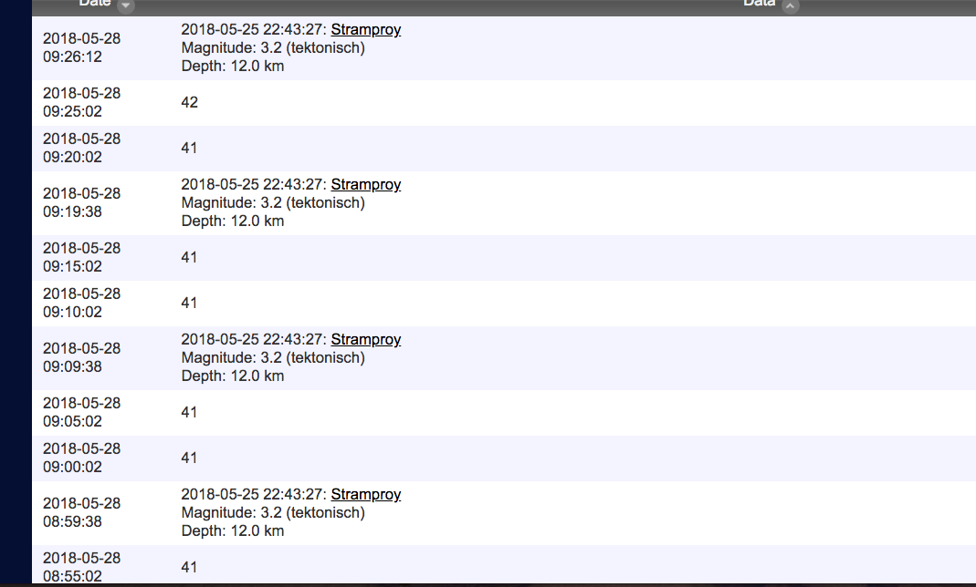

Lately I get numbers and double entries in the log.
Screen Shot 2018-05-28 at 09.28.49.png (127.36 KiB) Viewed 956 times
See attachment
