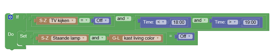

hi i want to trie to set off some lights together with my tv
this between times
i tried a couple of ways i tought this could work but nothing seems to
anyone know how to do this?

How can it be before 18 and after 19 at the same time?

Thats cous i was messing around with it . Tried it the other way around also

I'm just guessing here, as I'm no expert but you might want to try the following:
if TV kijken = off and time > 1800 and time < 19:00
Do
	set Staande lamp = off
	set kast living color = off
To clarify, use seperate sets for every different lamp.
Also make sure to set the blocky to "devices".

just tried it again like you said but lights do not react
when turning off the tv
status of tv dous change to off and time is set correct

Begin small, if tv is off switch light off. Then add one time condition and then add the second.
That way you'll learn better what happens.

thank you it workes i had the wrong control block
