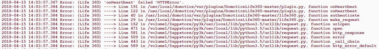

I get this error in my log :(
Is this a domoticz , python or life360 problem.
Running domoticz beta v 3.9208 on a synology.

Could be an authentication problem with life360: (Because of the HTTPError detail)
1. Enable Debug
2. Leave Google api key empty (to make sure the problem is in life30, not google)
3. don't forget to write your email address as life360 username, not only the username itself but includes @somethingemail.com. you can check your credentails from life360 web page login.
Maybe debug option can give more details.

I noticed the same and it's gone now. I suspect it was an issue with L360 itself.

Yes , it's gone. Like you suspect , it was a issue with Life360.
Thanks ;)
