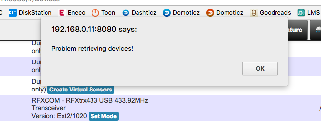

EdwinK
Posts: 1820
Location: Rhoon
Re: Python Plugin: Life 360 Presence Detection
Post by EdwinK »
febalci wrote: Wednesday 22 November 2017 8:13
Edwin, do you have something like this error in the beginning of your logfile?
PluginSystem: Failed dynamic library load, install the latest libpython3.x library that is available for your platform.
If you already have any working python plugin at the moment, than it's a fault on my code side, otherwise there's something wrong on your python or domoticz installation. If you also have a problem with the Buienradar, maybe it is possible that you do not have python plugins enabled on you Domoticz Beta? And also i believe you already have life360 account and set your username etc. Also, in the error of your Python path, there's no "/domoticz/var/plugins/life360" folder, that sounds like plugin support in your installation is flawed?
I can't check it at the moment. The second I activate one of the mentioned scripts, Domoticz stops working and will not continue before removing the plugins again.
EdwinK
Posts: 1820
Location: Rhoon
Post by EdwinK »
2017-11-23 18:05:20.211 PluginSystem: Started, Python version '3.5.3'.
2017-11-23 18:05:22.621 Python EventSystem: Initalizing event module.
EdwinK
Posts: 1820
Location: Rhoon
Post by EdwinK »
Giving up for now.
Error message AFTER activating python scripts
Screen Shot 2017-11-23 at 18.25.39.png (52.01 KiB) Viewed 12325 times
