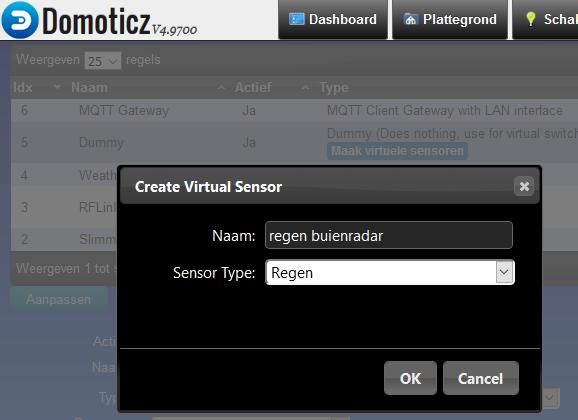

DickN
Posts: 8
Joined: Monday 06 March 2017 19:08
Re: Is it gonna rain within the next X minutes?
Post by DickN »
In Hardware I have created a virtual sensor with type Regen
In devices i can see now:
The attachment MWSnap002.jpg is no longer available
Idx=782
and in the weather tab:
is correctly shown
Also when I open the Log:
is alsocorrectly shown.
So far everything is OKe
When I edit my script with:
RainDeviceIDX=778
commandArray[1] = {['UpdateDevice'] = RainDeviceIDX .. '|'..tostring(RainPrediction)..'|'..tostring(verw)}
The divice in the weather tab is not lookingen like before.
The log-file does niet appear anymore.
Can somebody tell me what I did wrong
